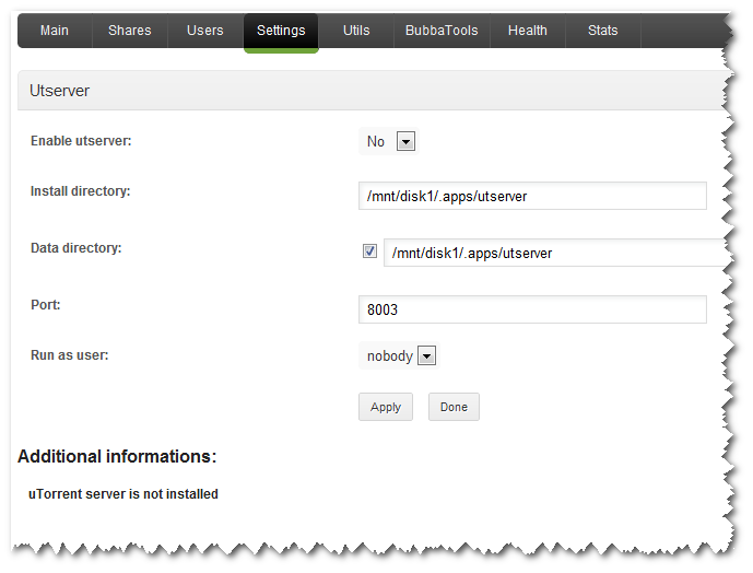

Hi
Just downloaded utserver 0.2.zip and copied the plg file to my plugin dir. Executed installplg and then I opened the web interface.
First, the log from installing doesn't seem to install any uTorrent server at all - only config
root@Tower1:~# installplg /boot/config/plugins/utserver.plg
installing plugin: utserver
file /boot/config/plugins/utserver/utserver.png: downloading from http://forum.
utorrent.com/img/avatars/120492.png ... 2012-06-15 10:01:51 URL:http://forum.uto
rrent.com/img/avatars/120492.png [1310/1310] -> "/boot/config/plugins/utserver/u
tserver.png" [1]
success
file /tmp/utserver-cleanup: successfully wrote INLINE file contents
  /bin/bash /tmp/utserver-cleanup ... success
file /boot/config/plugins/utserver/utserver.cfg: successfully wrote INLINE file
contents
file /etc/rc.d/rc.utserver: successfully wrote INLINE file contents
  successfully changed file mode
file /usr/local/emhttp/plugins/utserver/utserver.page: successfully wrote INLIN
E file contents
file /usr/local/emhttp/plugins/utserver/utserver.png: successfully copied LOCAL
file
file /usr/local/emhttp/plugins/utserver/utserver.php: successfully wrote INLINE
file contents
file /usr/local/emhttp/plugins/utserver/event/disks_mounted: successfully wrote
file /usr/local/emhttp/plugins/utserver/event/unmounting_disks: successfully wr
file /tmp/utserver-install: successfully wrote INLINE file contents
  /bin/bash /tmp/utserver-install ... success
file /var/log/plugins/utserver: successfully wrote INLINE file contents
plugin successfully installed
root@Tower1:~#

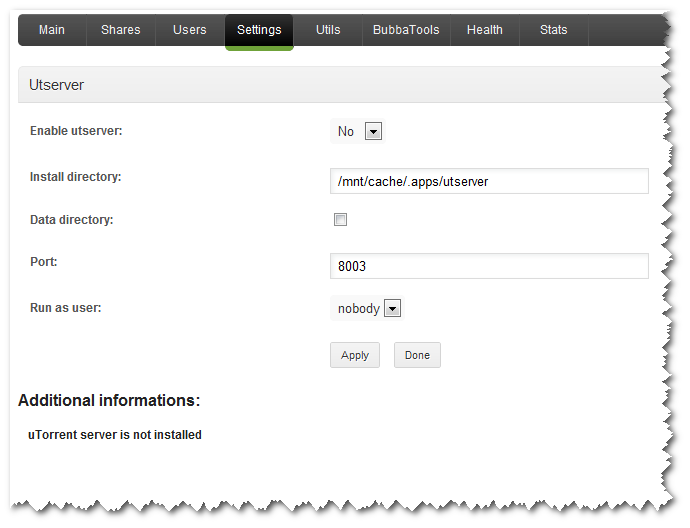

Then, when I try to edit the configuration, the path changes I do dissapears when I click apply.
Hi
Enable plugin before clicking apply.
Hmm. OK. I did that now. And it could be that it now saves the info. A little strange behaviour since if you select enable before you edit the fields, you can't edit the fields anymore and since the enable selection is the top most entry it is natrual to select that first.
Anyway. I'm still left with no luck. The page just waits forever when I select apply and the bottom line states "uTorrent server is not installed".  I suspect that this is because I can see no mention of any download of the uTorrent package in the plugin file.

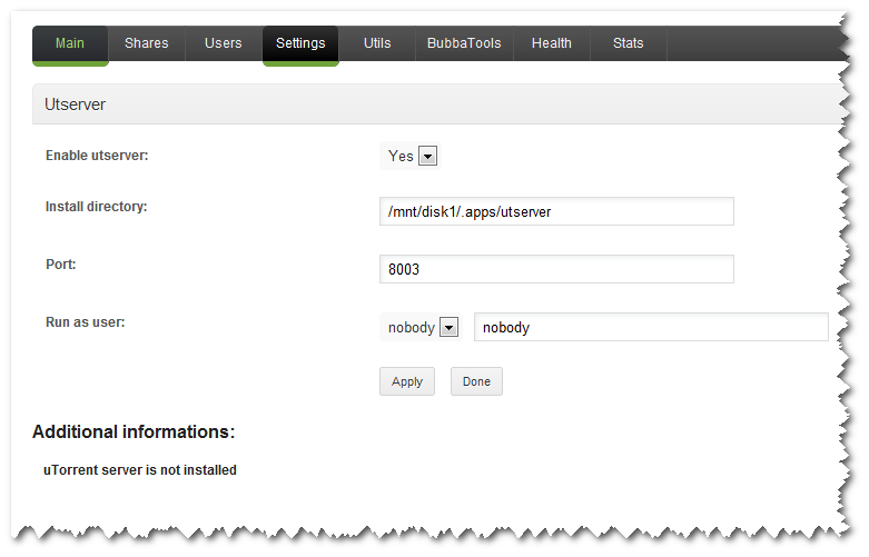

I thing I re-created the problem on my box and found the problem (i believe so) - installation script was checking for cache disk, and if not present it would wait in loop. Please download version 0.3 and reinstall.
Installed.
Now the setting for data directory is gone.
It's not possible to disable utserver - it just reverts to enabled.
uTserver is still not installed.
Try it with v.0.3.1, I forgot about one # in rc.utserver stop. Should be fine now.
Closing in....
Now it says:
installing utserver...
installing Version 3.0 (27079)
Starting utserver: sudo -u nobody /mnt/disk2/.apps/utserver/utserver -settingspath /mnt/disk2/.apps/utserver -configfile /mnt/disk2/.apps/utserver/utserver.conf -pidfile /var/run/utserver/utserver-8003.pid -daemon
And there it waits forever. But this I think is only an update issue, because if I return to the Utils menu by clicking the top menu and click on uTserver again I see the settings and it says "uTorrent server is running".
But I can't log in to the interface? I'm running uTserver as 'nobody'? Webpage asks for username and password, but none of my users id/pw will do.
Also, the configuration of the data directory is still commented out in the plugin code.
Login in as 'admin' with no password by default - then change it :)
What I can't work out is where utServer is writing it's config file for items changed in the webGUI, nor can I get it to automatically load torrents from a specified directory - which is a pain..  I've filled it in, the directory exists etc but it doesn't seem to find anything..
Ah... Cool
Now it works! (At least the interface, haven't had time to test uTorrent itself yet... )
