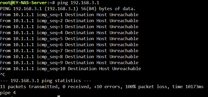

When i ping my router from the server CLI, i am unable to reach it; it seems that he is pinging from the wrong network interface, i.e. eth1, though:

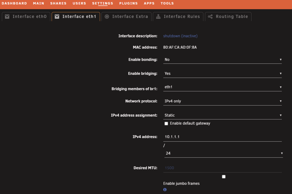

eth1 network settings:

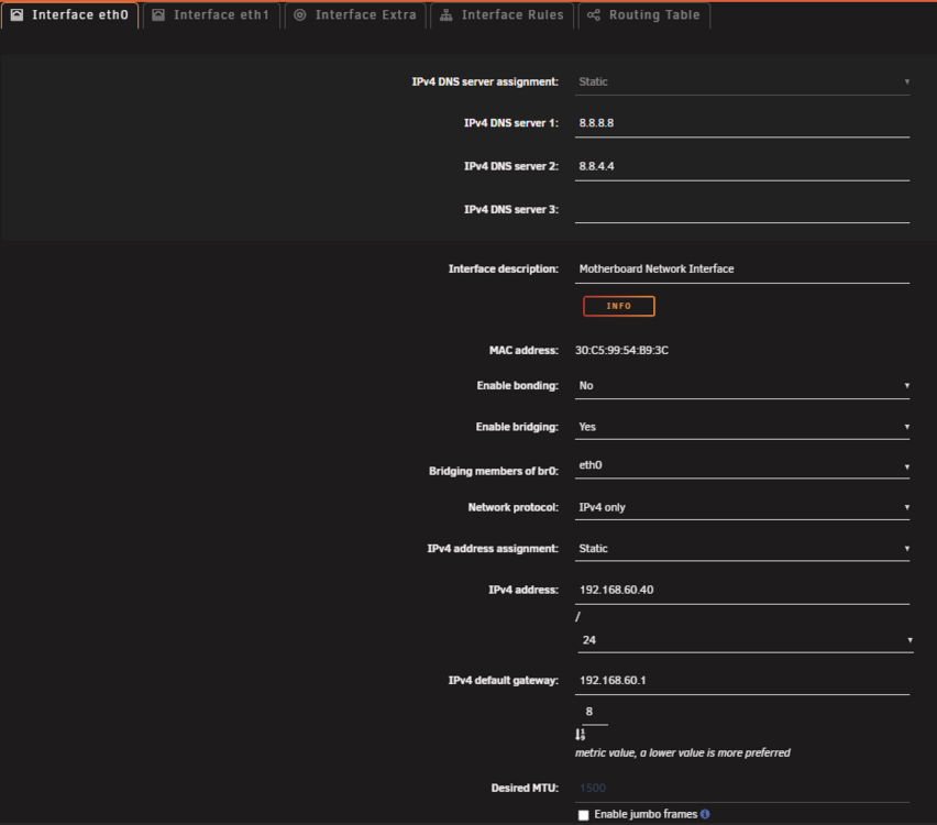

eth0 network settings:

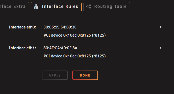

Interface rules:

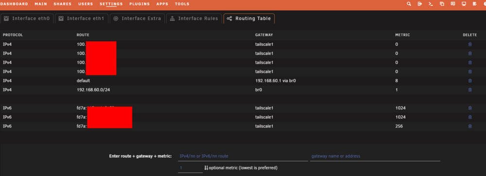

Routing table:

There are two gateways configured; only eth0/br0/bond0 should have a gateway. Remove the one from eth1.
Update, i have internet connection back by specifying the eth1 static IP address as 10.1.1.0 instead of 10.1.1.1.
This eth1 is for a camera subnet which i am still trying to set up, i was suggested by someone on github where i asked help for setting up frigate, that i probably should set my eth1 network interface to 10.1.1.1 instead of 10.1.1.0. But i guess this is not the right way then.
