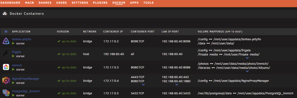

the Frigate container seems to be assigned the IP address of my server on the main VLAN, and hence doesn't seem to have an IP address on the camera subnet:

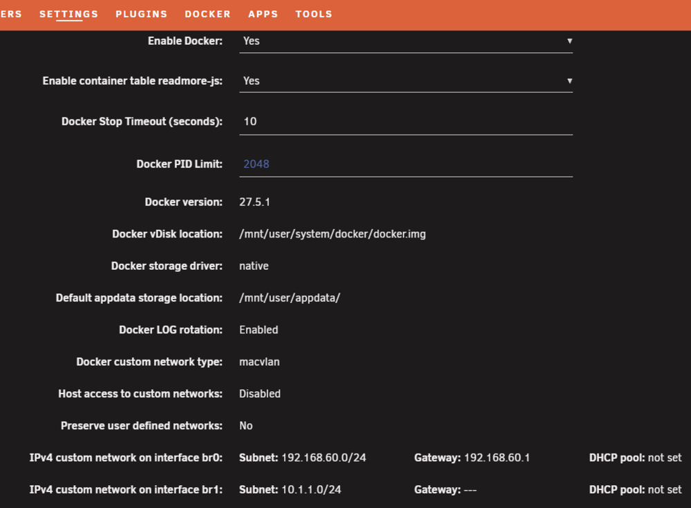

Below my docker settings:

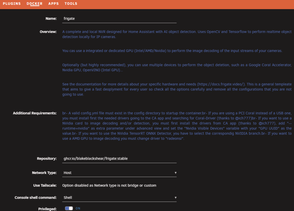

and my frigate container settings:
My frigate container network type is set to host instead of bridge in order to have access to both eth0 and eth1, maybe i need to also configure something else? Or is this not the right approach and should I create a MACVlan or IPVlan? Not sure how to do this though so if someone could provide some guidance please?
I also noticed that in the network type options br1 is not shown as an option which leads me to believe that eth1 (br1) is not passed to docker or its containers. is this observation correct?

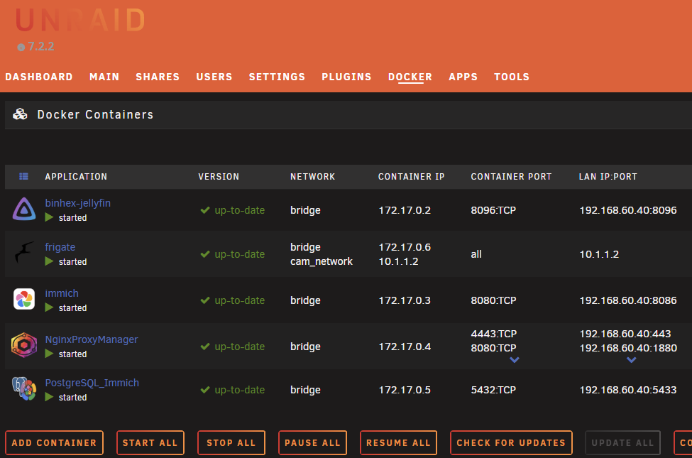

I think i managed to have the frigate container have access to both eth0 and eth1 by following instructions from gemini which told me to define a macvlan for br1 (eth1).
i did this by puting in the cli:
docker network create -d macvlan --subnet=10.1.1.0/24 --gateway=10.1.1.1 -o parent=br1 cam_network
then i added the following to the post arguments in the frigate docker container settings:
&& docker network connect cam_network frigate
Now frigate seems to have an IP address both on the bridge network and the cam_network.

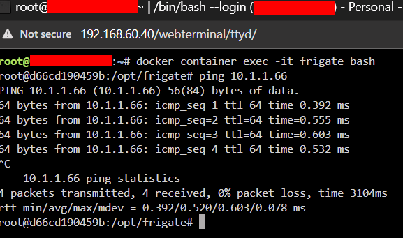

In order to be able to pign my camera, i first had to install the ping utility in the frigate container, as it seemed to not have it by default, i did so by following these instructions i.e. putting following commands in the CLI:
docker container exec -it frigate bash
apt update
apt install iputils-ping
exit
then pinging the camera from frigate via the cli gave the following result:
