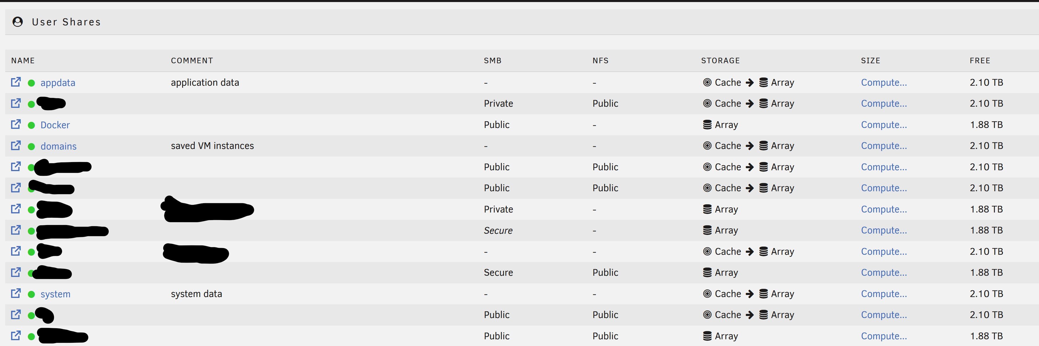

I am preparing to move my unraid into a new server (new proc, mobo, mem, nvme cache drive). The array storage will remain the same, I'll just move them into the new case. My old cache drive is a pool of small m.2 SSDs. They will not be moving to the new server. So I'm trying to ensure everything stored on them is moved off. I had three shares set to store in cache (array->cache) : appdata, system, and domains. I changed those to cache>array and ran the mover.

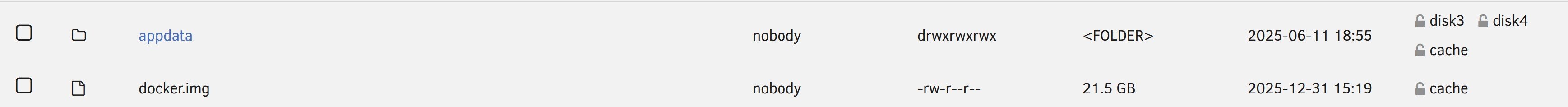

The problem is my docker image and all of the appdata for my docker apps is still sitting on the cache drive. Not just a copy but that appears to be the only location. If I look at the shares it only lists cache for these files and folders. The funny thing is the Docker share was set to array only. I never changed it yet the docker.img is only located on the cache.

A few files are on array disks but mostly it says they are on the cache.
I think I have it all figured out. The steps in the guide are what I had done. The issue I found is that I had mapped most of my docker apps as well as the docker image directly to the cache ie /mnt/cache/docker/appdata/blahblahblah.
To fix I set my docker and appdata shares back to cache and ran the mover. Then I modified all of the necessary paths and pointed them through the docker share ie /mnt/user/docker/blahblahblah. I confirmed all of my docker apps were able to run then shut them down again and disabled docker.
I then set the docker and appdata share along with all others to move cache->array and ran mover again. Everything moved this time.
