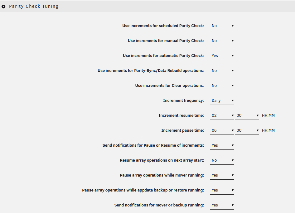

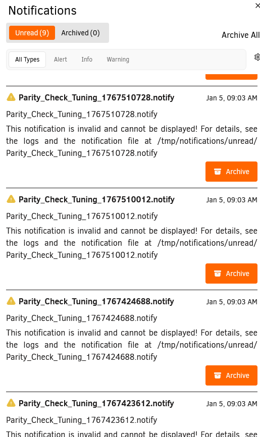

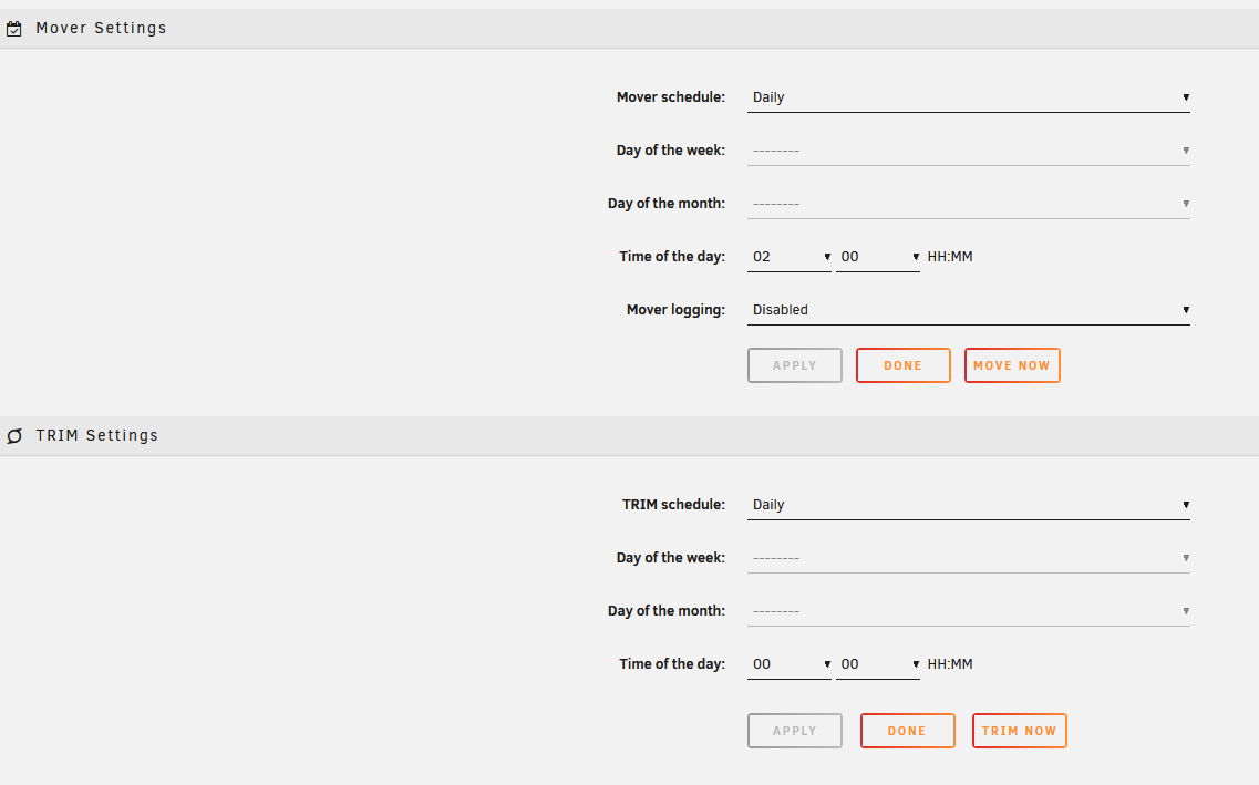

The rebuild seems to have finished successfully. Thank you both for your help! One thing I have been getting is errors during parity checks. I beleive it is due to my Parity Tuning Settings and having it "pause" during nightly scheduled Mover, but am not experienced enough. I thought I had it set up correctly, but again, am uncertain. Could y'all look at the attached and/or give me any suggestions please? Should I simply ignore these errors? Is there a better way of operating?
Thanks
I think I may have figured this out. I think it was my SMTP/Gmail password for my notification settings. I created an App Password in Gmail and my Test in settings was succesful. Not sure how to test it otherwise to see if it resolves the issue I describe above. I guess I'll wait till the next Parity Check nest month.
