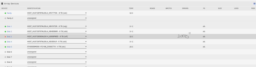

Oh my. I just noticed the 2000+ errors. That just came out of nowhere.
how the hell are there 2000+ errors but SMART passed?
It's not logged as a disk problem and SMART looks fine, so most likely a power/connection issue.

Even with all those errors? It says over 2000 errors on the disks page

One of the data disks randomly is down, passes smart and has 2000 errors on the disks page. I have been told that from the diagnostic results, there is no issue with the drive.

image.pngtower-diagnostics-20260101-1231.ziptower-smart-20260101-1227.zip
Emulated disk3 is mounted so should be OK to rebuild after fixing connections.

You must rebuild disk3 unless you want to lose its data. And dual parity doesn't really make sense with so few disks anyway.
You can rebuild to the same disk though, and that is what we recommend since the emulated disk is mountable.
