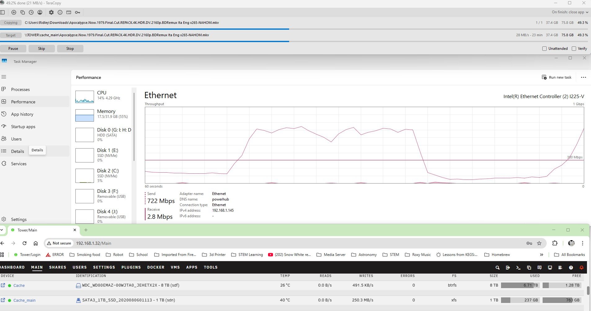

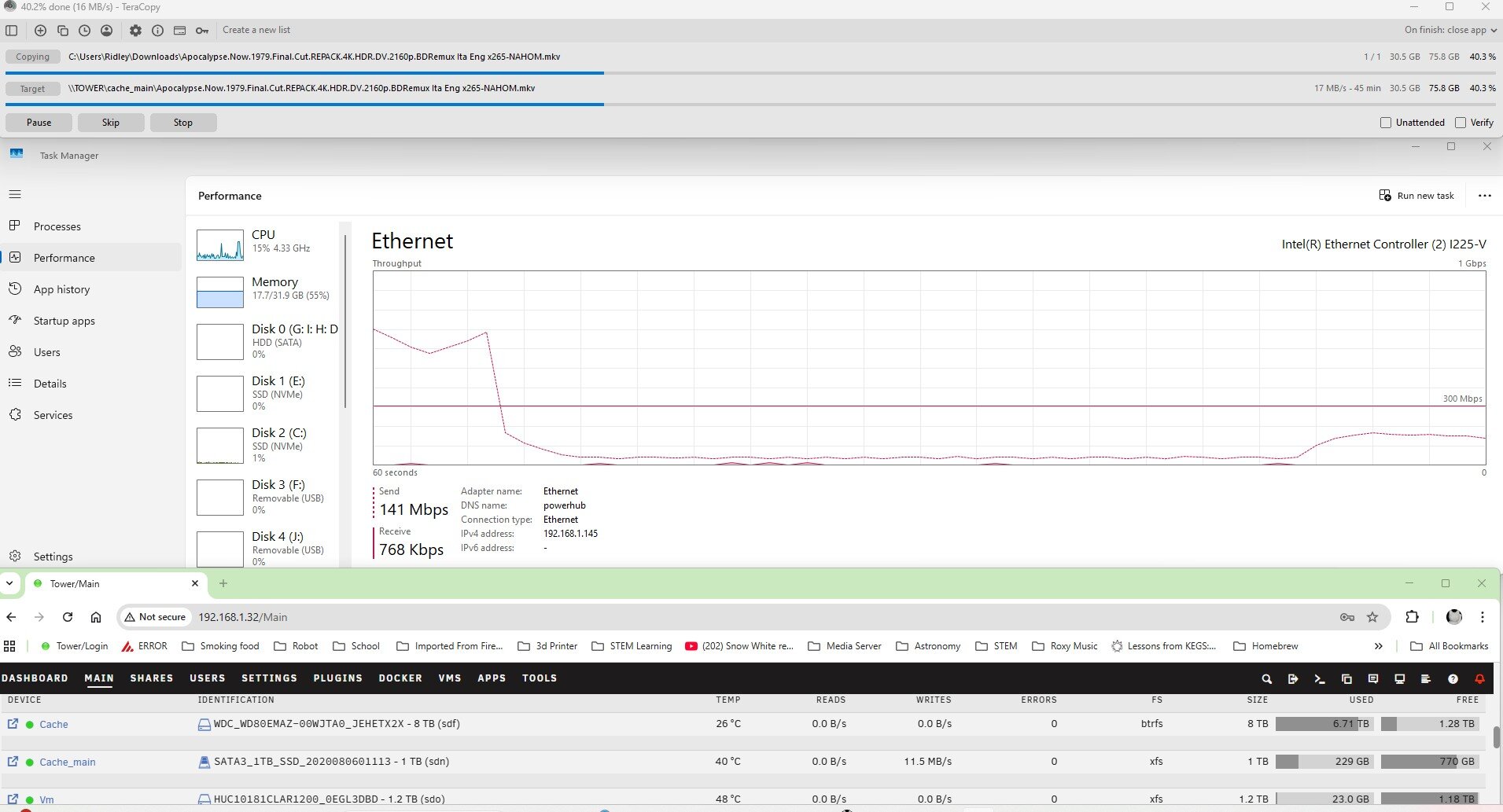

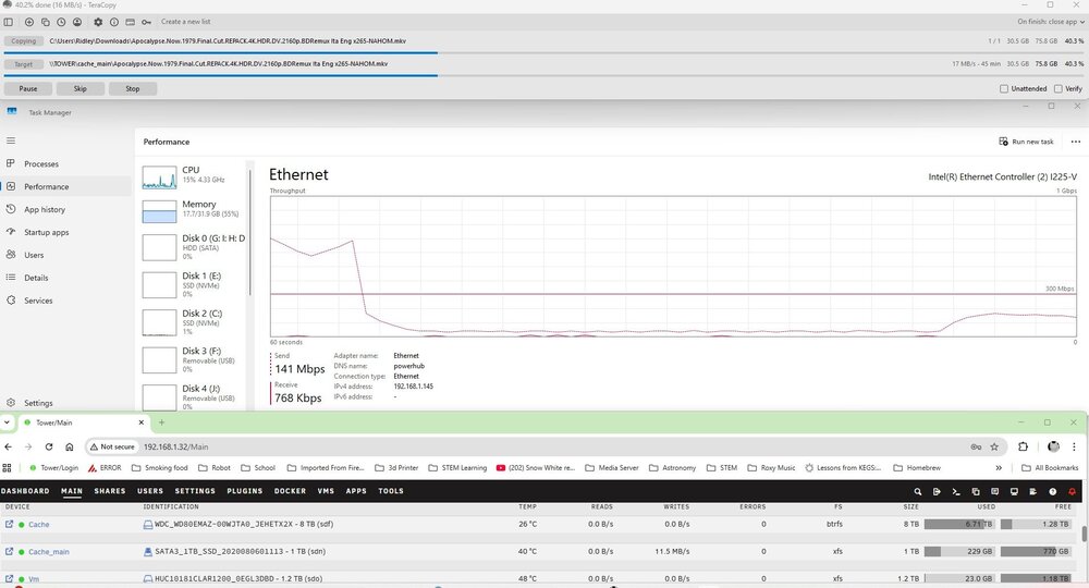

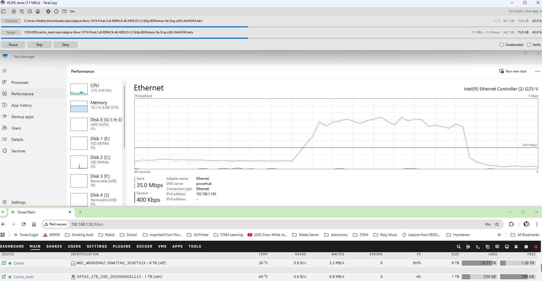

This is a transfer directly to the ssd cache drive "Cache_main"
It goes at full speed for about 5 minutes and then it starts doing this.

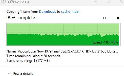

1 hour ago, JorgeB said:
I meant the Windows Explorer graph, like this:
That suggests to me the LAN is OK, the device cannot keep up with the writes, note that most SSDs use a pseudo SLC cache that can vary in size from model to model, and also depending on how full the device is. When that is exhausted, the writes are limited by the actual TLC (or QLC) NAND speed, also considering that it looks like the SSD doesn't have a brand, so possibly it's just that slow once the cache is exhausted.
