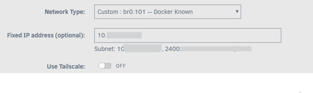

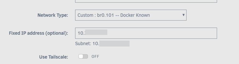

For some reason the Ipv6 option isnt showing for my 101 network but its showing for all others,
So when I'm using a Docker for 101 I see
But any of the others which show Ipv6 I see
Did I miss a step which would prevent me from allocating the IP on the specific Docker Network under 101? I dont know why one would show when the others do not,

you would see the ipv6 subnet there as well, this just set the --ip=#### line in the extra parm.
while in theory you could set a ipv6 address there it would be using ipv6 to ipv4 tap to tunnel over ip4 in that state based on the picture.
since you have preserver user defined on. I would remove docker setting checmark for br.101
and create my own docker network to have ipv6 enabled.

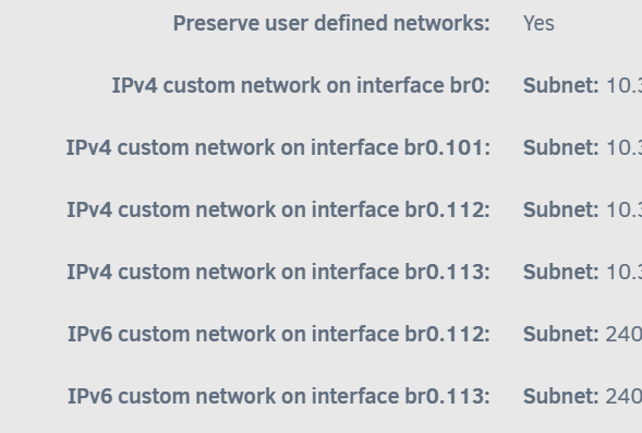

2 minutes ago, bmartino1 said:
as essential the docker network done't have ipv6 enabled.
Yes I found that out the hard way that enable of IPv6 in Networking dosnt enable it on Docker until you check the box ) But thats the funny thing, the Docker page is missing the option for 101 but all others are showing even when SLAAC is disabled,
the inet script by unriad din't detect ipv6 comunication and thus ran teh compabilty bug patch to force ipv4 for docekr networks.
you have to not let unriad define this and manualy run commands to set the interface ip and make the docker network.
again unraid docekr setting didn't see ipv6 use docker network inspect it will say ipv6 disabled ... this is what your fighitng...

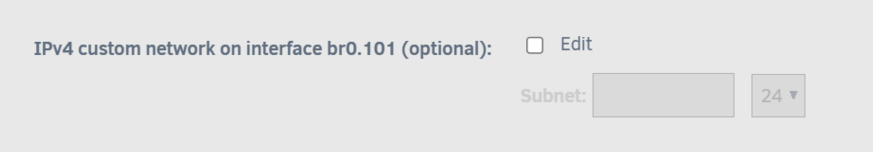

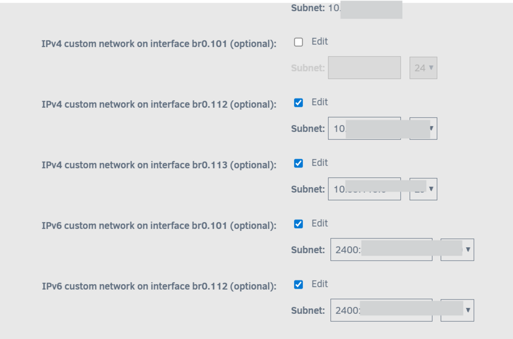

Also I think I just fixed it... Or I broke something else,
I found that my Network settings for 101 was both set to Auto but the rest had None on the interface, switched it and now under Docker I see the option to assign the IP range now, (which oddly enough Unraid only supports /120 not higher)
So to validate I dont enter the IPv6 in the Fixed address box like the example text shows I need an extra para?
Edited by brent3000
correct as now when docker starts unraid will make the network based on setting defiened in the config.

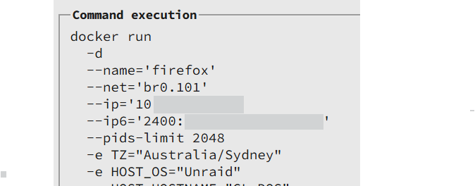

So using the template, (Sorry I dont use the scripting much I'm a GUI kinda guy ) ) do I follow the example below and use a , between the IP's or does this support one or the other when setting an IP?
So would it be x.x.x.x, xxxx:xxx:xxx::x or do I always need add a custom config?

Correct so now in the fixed ip in the docker temple you can comma separate it but add a static ipv6 address here for that docker to be statically assigned to.
as you have user define enabled the docker ipv 6 should be saved across reboots. You apear to be golden and setup corectly now. UNriad and vlans can be problematic. it usualy statis withteh ipv6 dhcp server and slacc based on the default shiped inet script.

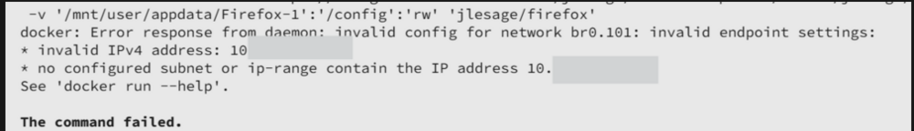

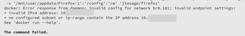

So I thought I was on a roll but when I went to test it the command did split the IP's correctly it seems
However all my dockers pre-setup work, any new one (I Was trying Firefox to test it and it keeps failing)
Would this be that command you mentioned I need to run to fix this? Its all entered in the GUI but is something 'not' configured and still needs that CLI run for any new IPv6 vlan I added?

the error say it all. this tells me the br0.101 doesn't have a ip route and may not have a ipv4 address added to it to communicate to the 10.x address you have.
IDK why that is.
if you run ip a
does teh br0.101 have a ipv4 address as well?
if you run iproute
do you see a route for that subnet 10.x network for br0.101 ?
that would be the networking gotcha at this point.

Looks like it has a bunch of things but looks like its just the mac details
275: br0.101: <BROADCAST,MULTICAST,UP,LOWER_UP> mtu 1500 qdisc noqueue state UP group default qlen 1000
link/ether d0:50:xx:xx:xx:17 brd ff:ff:ff:ff:ff:ff
6 minutes ago, bmartino1 said:
iproute
Command not found?

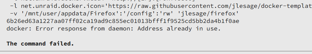

Now its giving me a more generic error
Can confirm my other docker's which was done before and already installed, working fine no internet issues
