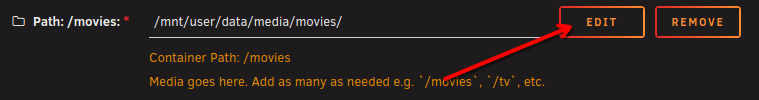

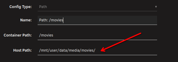

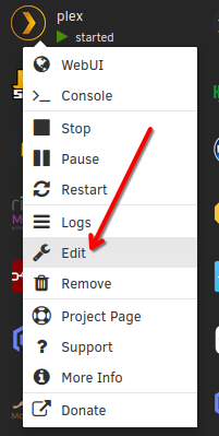

    Click on the plex icon on the unraid dashboard, click on EDIT and then click edit on the Movie path post a screenshot of that because I suspect something For some reason your MOVIE share has a MOV

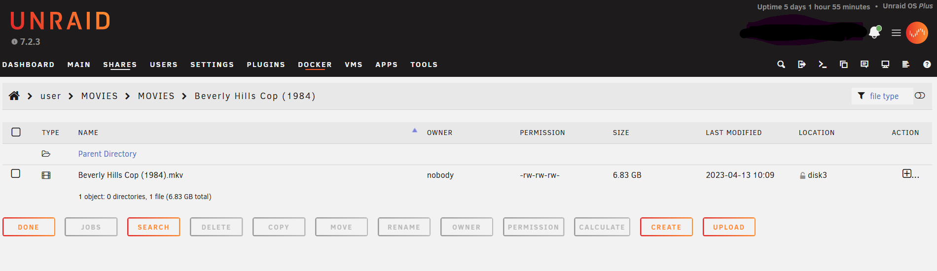

Unraid's File Manager works like most computer directory interfaces (like Windows Explorer, in Details view)
Click Shares and you will see a list of your shares. My media is in the Media share (imaginative, ain't I?). A Share in Unraid is basically a top level folder in Windows. If you click on the icon to the left of the Share's name, it opens the share (folder).
I'll move down to a movie in my Movies folder:
Looking at the screenshots above you will see that for both the sub-folders and the media, the OWNER is nobody. The PERMISSIONS are allowing everything for folders, and allow reading and writing for the media files (you can find many video or text tutorials on Linux permissions, I'm not going there today).
We have no idea how you are downloading your media, how that is configured, or if the media is where Plex expects the files to be. So you need check just where the files are (in the correct location for Plex to find?), and are the Permissions and Owner the same as the Media files Plex is able to read (this can block a program/user from seeing/using it).

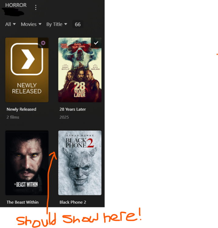

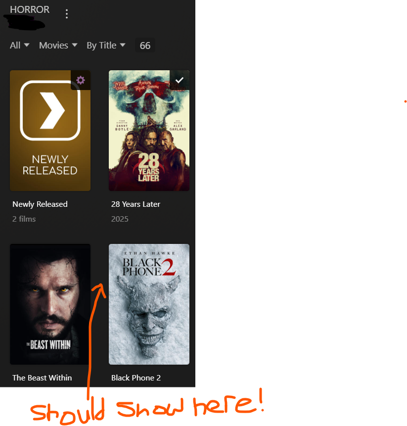

Post a screenshot similar to the one above that shows an actual movie file that Plex doesn't see.
The film below shows in Explorer, but not in Plex.
Hope this helps.
I was asking for a screenshot similar to this one which was posted above:

@trurl My system doesn't look like that.
@SPOautos I have already done a "Scan Library Files" and nothing changed. (
Here is my version of that movie.
Permissions look OK. Maybe a Plex database issue?
For some reason your MOVIE share has a MOVIE folder in it and I think this might be an error on your end.
