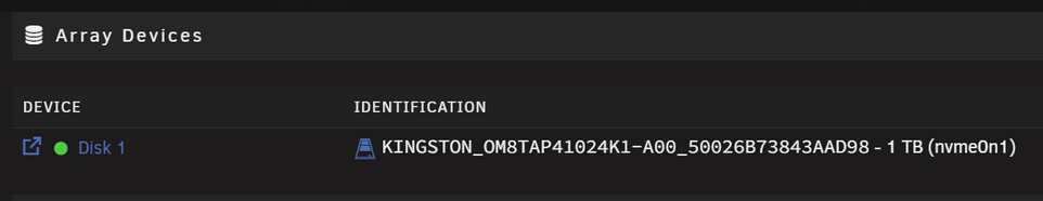

(It complain about parity hope that goes away if I remove the one Nvme drive (As this one drive is now listed in my Array)

You will need to assign your SSDs into an unraid POOL... Not the Array as you currently have it.
This is not advised (should only be used for HDDs):
Below this, there is a "Create Pool" button when the array is stopped/offline.
In order to fix your mistake, you will need to go to the TOOLS menu and select "New Config" and do not preserve any slots. This will let unraid forget the drive assignments so you can move it to a pool without unraid throwing a fit.
