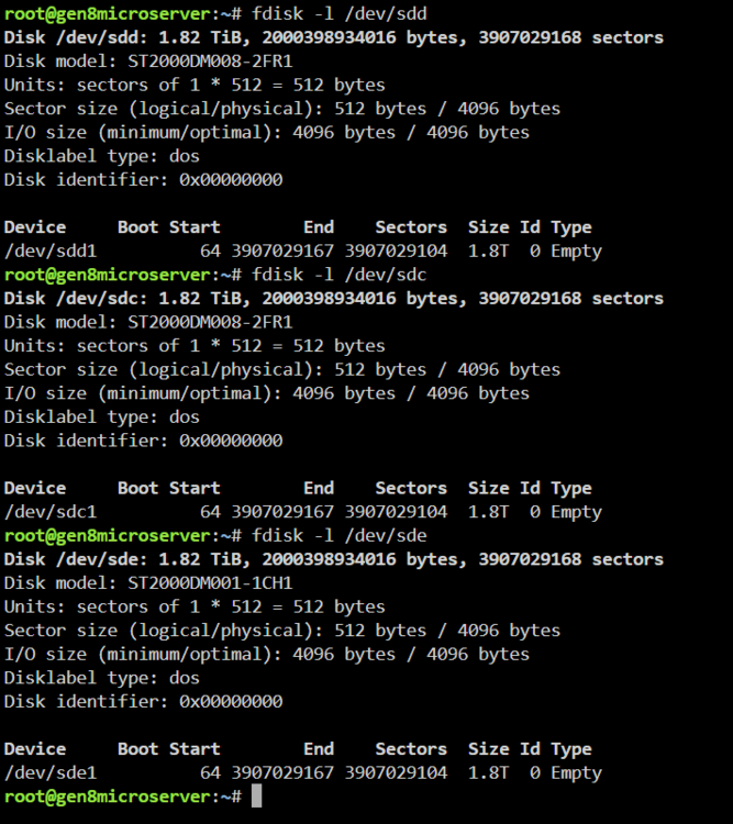

Disks are showing up as precleared; post the output from fdisk -l /dev/sdX for all disks.

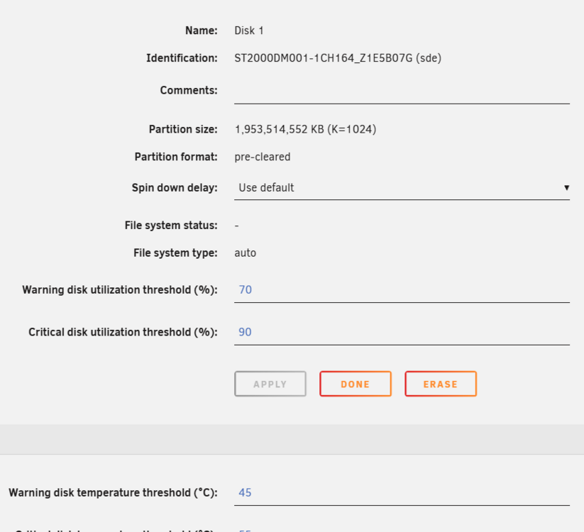

no option to check disk in the gui when in maintenance mode
Edited by beng40
All the disks have a pre-cleared partition layout.
