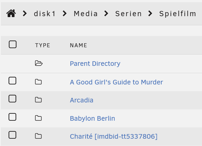

Recently I had the issue that all my shares where gone. Doing a quick google research revealed that a reboot might fix the problem and it seemingly did. Now a couple of days later I have found a folder that is empty in the share but has data in it when exploring the disk. In the parent directory in the share it shows 5 disks as being used.
As I currently have about 20 TB of data on the Server I am unable to check for more missing folders.
Here are some screenshots:
How do I get my files back into the shares?

After doing a file system repair I have gotten back the files from the original folder, but some new files have gone missing in the share. The repair moved some jellyfin metadata into the lost + found which I deleted because they can be regenerated easily.
The files in the Dump folder have been uploaded after the mentioned reboot after which the first files went missing (I didn't notice yet). I can copy them over again but I feel still unsure about other files being there.

Your diagnostics shows the Media share is only on cache and disk1.

While deleting the lost + found I managed to disable all disks except disk1 from all shares. Now everything appears to be back.
