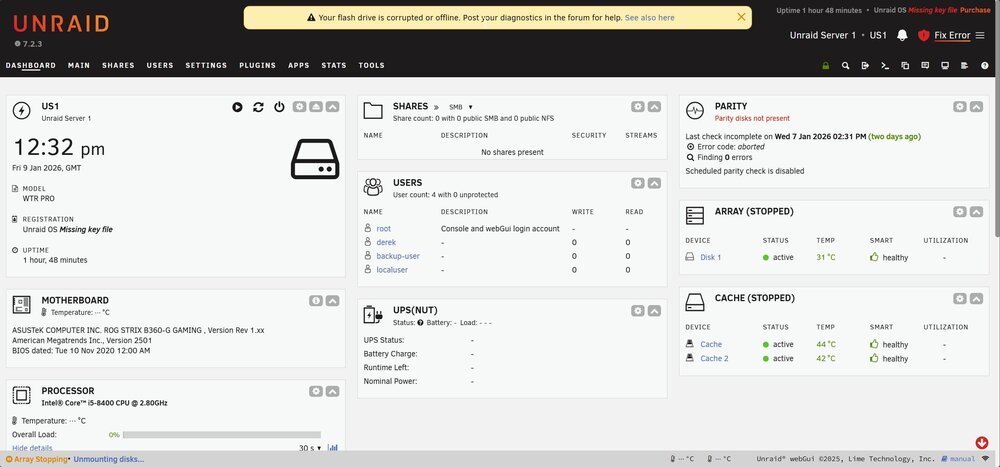

I rebooted the server this morning and it ran for maybe 60 minutes, it didn't go completely unresponsive this time I got the following error:brave_UT7DZ8mQB3.jpg
It's reporting the key file is missing and the USB is offline, if I reboot the server it comes back online but the same happens after a random period in time.
I have done what the screen request and posted diags if anyone can have a look and try to help me understand the issue and what needs to be done.
us1-diagnostics-20260109-1233.zip
Edited by DeekB

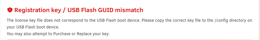

Thanks, I have tried different hardware and different ports previously, so have proceeded to replace the drive with a spare I had, I restored a backup of the key I had using the unraid media creation tool.
I now have a new issue
I have tried replacing the key from the registration page but it seems it reported as a blacklisted key (I may have used that key for a trail version in the past)
Have opened a ticket with UnRaid support, also I have ordered a new key from Amazon which should arrive tomorrow as I dont think black listed kesy can be unblocked.
