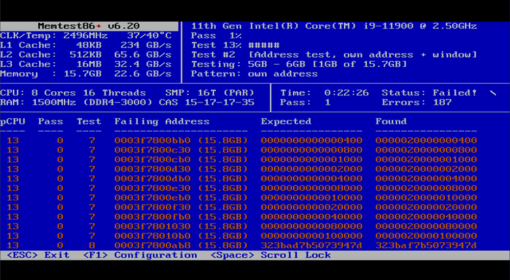

Have you done memtest?
See if you can get diagnostics immediately after rebooting, and setup syslog server.
Seems like my ram is A**... ;D
You should not attempt to run any computer unless memory is working perfectly. Everything goes through RAM. The OS and other executable code, your DATA. EVERYTHING. The CPU can't do anything with anything until it is loaded into RAM.
Yep, I know. Luckily I had another pair of working RAM in an older server and now it's working and tests passed.
