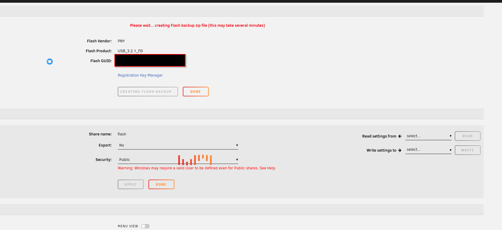

I'm attempting to back up my USB drive using UnRAID, but I'm encountering an issue where the process never completes and appears to be stuck. I've let it run for several hours without success. Does anyone have suggestions for resolving this?

Are you trying to download a flash backup from the webUI?
Attach Diagnostics ZIP to your NEXT post in this thread.
Flash backup process is timing out, you may not have enough memory to run that from the GUI, rootfs is only half installed RAM, 1.9G in your case, and the flash drive is using 1.8G.
You can always do a manual backup.
Al you really need is the ‘config’ folder off the flash drive as that contains the licence file and all user settings.
