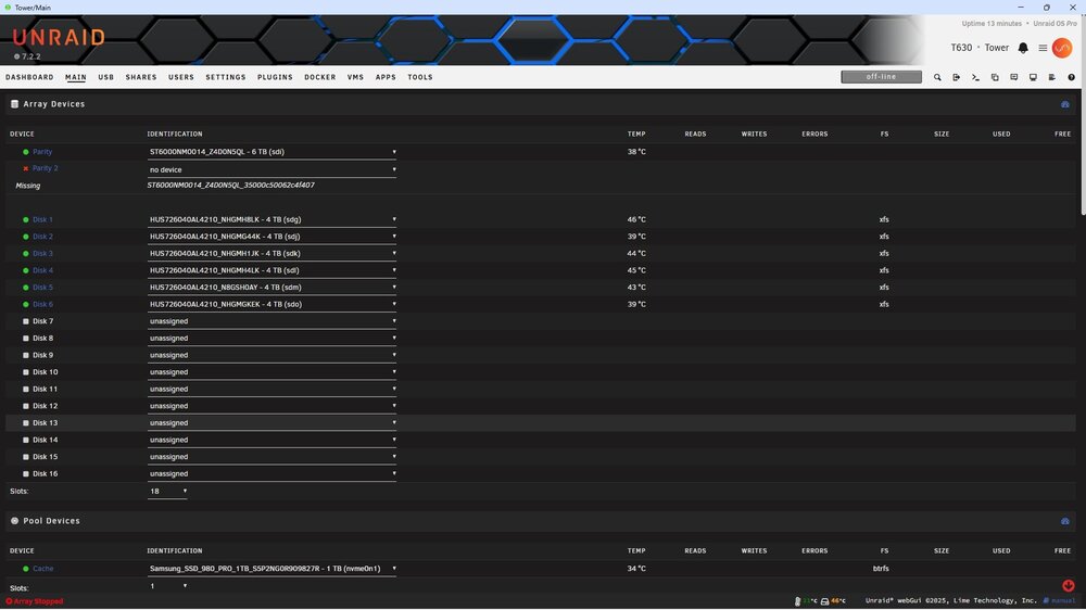

I looked at the [Main] tab, and it says... well, see the screenshots, please.
I don't understand. The drive it says is "missing" is the one that's listed right there as "parity".

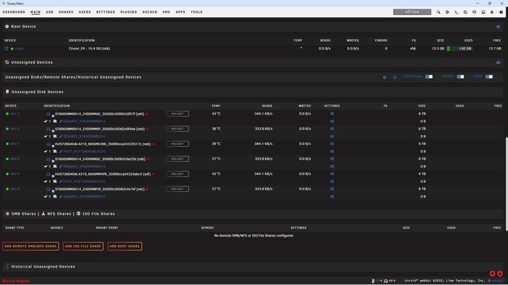

Parity 2, which is currently empty, was previously another 6TB drive of the same model, which is now listed down under unassigned devices, although I have no way of knowing which one it was, since I have several of those drives. I was still sorted out how to handle the expansion of the array, so they were just hanging out in reserve.

EDIT: From looking through the logs, I'm fairly sure that (sdh) is/was Parity 2, since it's the only one that isn't flagged as 'pre-cleared'. I had run pre-clearing on the other drives to get them ready to add or swap in later.
EDIT 2: This makes no sense. Am I seeing that it's expecting both Parity and Parity 2 to be drive S/N ...DON5QL? That's not possible, right? Has something gone glitched here?

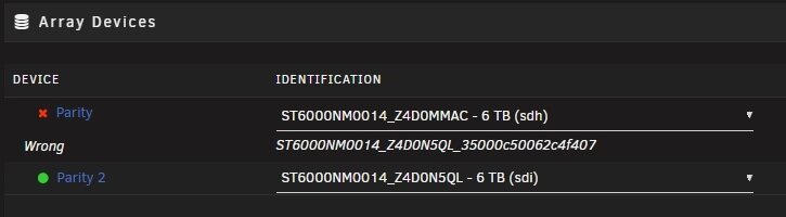

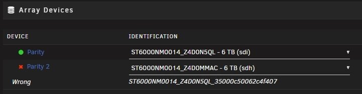

I thought maybe that drive got assigned to the wrong parity slot somehow, so I moved 5QL to Parity 2, and assigned drive xxxMAC (the one that I'm fairly sure was one of the parity drives before all this happened) to Parity.
Now it says that Parity is "wrong" and is looking for 5QL, even thought that drive is in the Parity 2 slot. (see new screenshots for clearer explanation).
I tried flipping the order around, and it doesn't like that either.
I'm fairly sure that the correct assignment should be drive MAC (sdh) in the Parity slot, and drive 5QL (sdi) in the Parity 2 slot, but it says these are wrong.

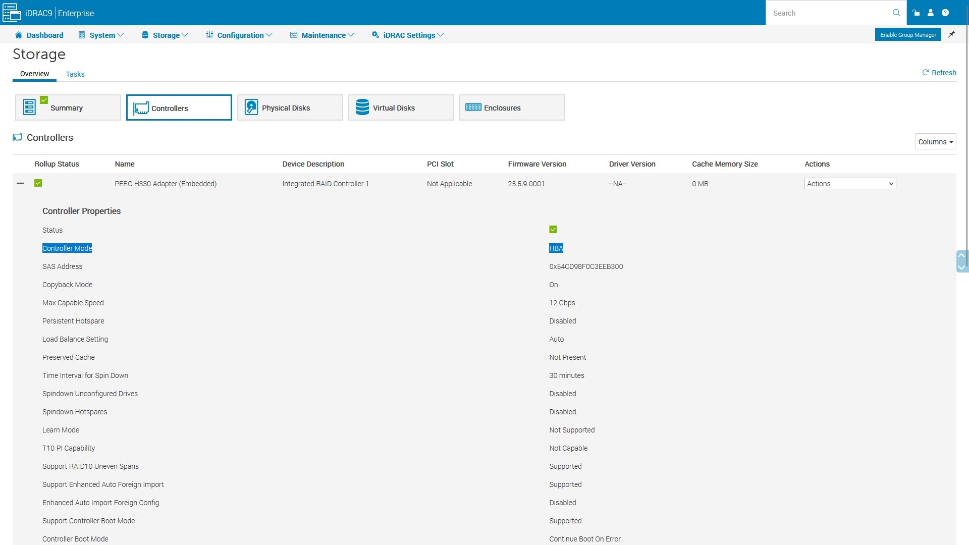

Ok, I understand that part now. You're saying that you don't think my PERC is in HBA mode. I'm trying to get into the iDRAC to check, but it seems to have hopped IPs on me when I rebooted. Standby...

In the screenshots for your parity assignments, the wrong is showing you what it thinks should be assigned there. I don't know if that 35000 part at the end agrees with what the controller is currently telling it or not.
I see! So it's not just the actual drive serial, but also the controller assignment, or whatever that number is, that could be tripping it up?
I finally got into iDRAC (flippin' ethernet cable was unplugged!) and was able to check status of RAID controller. See screenshot.

Other than switching it to "HBA mode" in the UEFI, which Dell says should operate as "drive passthrough", I don't know what else to try. It doesn't appear that there's an option to flash this card to true IT mode like I did in my T630.
