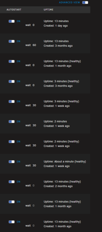

My docker containers aren't loading in the order they are supposed to. Several of the docker containers down the list load instantly (Radarr, etc.).
Currently I have it set with a 300s wait on Unassigned Devices to mount SMB for the Synology to start. Assuming Docker starts loading at the same time I set Homarr and Satisfactory to load and then wait 600s before starting to load media stuff that targets the NAS.

I use 300s delay on mounting the Synology so it can start up before Unraid tries to mount it. Homarr and the Satisfactory server can load straight away. So I was using the Satisfactory container to put in a wait to clear the Synology mount time. Some of this is working great and stepping through and loading them. But 4 ignore the delays and just start as soon as Unraid starts. And those are the ones that really need to be delayed because they target the Synology.
In the screenshot you can see the first two starting at the same time at the start with a (currently) 600 wait but the 3rd one loads at the same time anyway. Then it's working correctly and stepping through down to those last 3 that started with the first ones.

Interesting place to put that. I did that and turned off all auto starts. I still have the same 5 containers autostarting anyway.
What are those containers? Are they installed from templates or other sources like the Compose plugin or other managers e.g. portainer? The Docker page options only apply to things installed with Unraid's built-in system.
