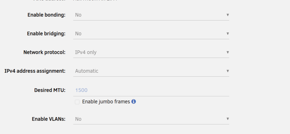

You seem to have Jumbo frames enabled. This has given problems in the past. Suggest returning to the default. (MTU = 1500)
As far as I can tell I don't. I'm assuming you mean on my server?
I got that from this syslog entry:
Jan 8 16:36:11 TerraFirma kernel: r8169 0000:02:00.0 eth0: jumbo features [frames: 9194 bytes, tx checksumming: ko]
Odd, not sure why it's showing that as my server doesn't have it enabled as per my screenshot above. Not sure where else to look to see if it's set differently than what is shown.
There are a number of strange things going on in your Syslog. I wish that someone with a good knowledge of reading syslogs would have a good look at it...
