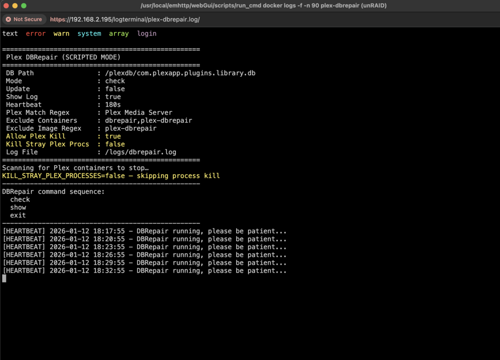

  1. Connects to the Docker daemon through /var/run/docker.sock (not a second Docker daemon).
  2. Finds exactly one running Plex container with a database at the expected internal path; or selects an exact name from PLEX_CONTAINER_NAME.
  3. Reports target image, container ID, mounts, restart policy and database location in the logs.
  4. Copies the bundled DBRepair executable into the Plex container using docker cp and runs it with docker exec.
  5. Requests graceful Plex Media Server shutdown through DBRepair stop, with a SIGTERM process fallback when allowed; verifies the PMS process has exited and the container remains running.
  6. Creates a verified cold .tar.gz database backup by default (except prune), runs the requested native DBRepair operation, and restarts the Plex Docker container on success if enabled.
  7. Exits automatically, writing Docker console output and a timestamped persistent log.

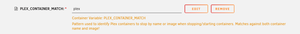

For the Docker Variable Plex_Container_Match:
it is best to give your dockers plex repository image... example pulled form the Unraid tempalte
or docker name
*Or stop them yourself and run the docker... setting the options to false (true by default...)

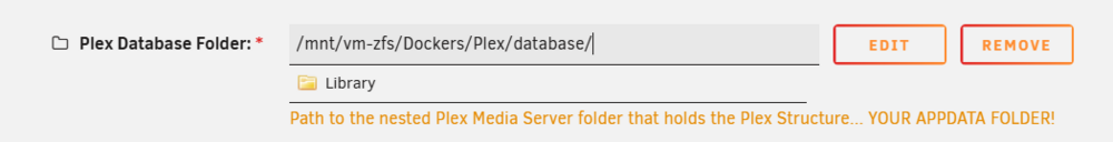

We also need to mount the Plex Folder structure. I have my plex media on a zfs share per example we want the docker to show /config/Library/...
example we must mount the plex nested folder "Library folder here"
parts of the prune script and others are implemented that need access to the cached folder... (original script only wanted the nested database folder.)
: "${PLEX_MOUNT:=/config}"
: "${PLEX_REL:=Library/Application Support/Plex Media Server}"
AS I try to make universal dockers while unraid designed I try to accommodate other systems... as such if your folder structure is non default...
you can call the variable "PLEX_REL" to complete the nested folders If non default... so the docker can still access correct pathing.
the goal was to reliably add the appdata folder that contains Library to the Plex Media Server to target the needed files and other locations...

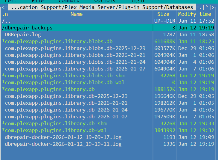

the log file will be in the database folder. Including a subfolder backup:

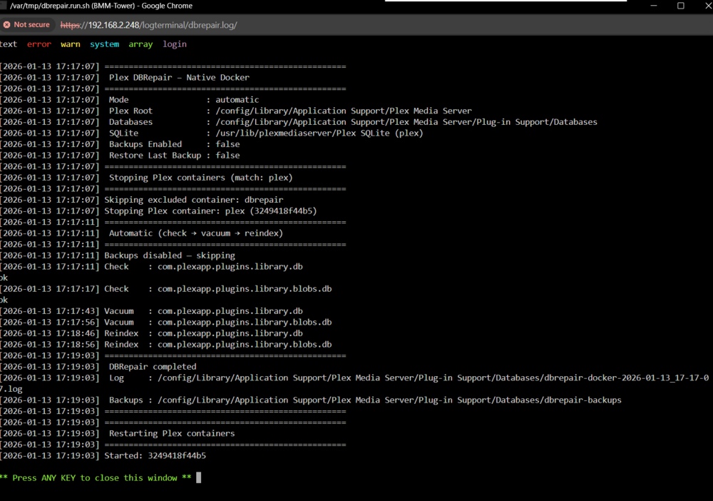

Example:
Where logging happens: /mnt/user/Dockers/Plex/database/Library/Application Support/Plex Media Server/Plug-in Support/Databases# cat dbrepair-docker-*.log Per the Timestamp
root@BMM-Tower:/mnt/user/Dockers/Plex/database/Library/Application Support/Plex Media Server/Plug-in Support/Databases# cat dbrepair-docker-2026-01-13_17-17-07.log
[2026-01-13 17:17:07] ==================================================
[2026-01-13 17:17:07] Plex DBRepair – Native Docker
[2026-01-13 17:17:07] Mode : automatic
[2026-01-13 17:17:07] Plex Root : /config/Library/Application Support/Plex Media Server
[2026-01-13 17:17:07] Databases : /config/Library/Application Support/Plex Media Server/Plug-in Support/Databases
[2026-01-13 17:17:07] SQLite : /usr/lib/plexmediaserver/Plex SQLite (plex)
[2026-01-13 17:17:07] Backups Enabled : false
[2026-01-13 17:17:07] Restore Last Backup : false
[2026-01-13 17:17:07] Stopping Plex containers (match: plex)
[2026-01-13 17:17:07] Skipping excluded container: dbrepair
[2026-01-13 17:17:07] Stopping Plex container: plex (3249418f44b5)
[2026-01-13 17:17:11] ==================================================
[2026-01-13 17:17:11] Automatic (check → vacuum → reindex)
[2026-01-13 17:17:11] Backups disabled — skipping
[2026-01-13 17:17:11] Check : com.plexapp.plugins.library.db
ok
[2026-01-13 17:17:17] Check : com.plexapp.plugins.library.blobs.db
ok
[2026-01-13 17:17:43] Vacuum : com.plexapp.plugins.library.db
[2026-01-13 17:17:56] Vacuum : com.plexapp.plugins.library.blobs.db
[2026-01-13 17:18:46] Reindex : com.plexapp.plugins.library.db
[2026-01-13 17:18:56] Reindex : com.plexapp.plugins.library.blobs.db
[2026-01-13 17:19:03] ==================================================
[2026-01-13 17:19:03] DBRepair completed
[2026-01-13 17:19:03] Log : /config/Library/Application Support/Plex Media Server/Plug-in Support/Databases/dbrepair-docker-2026-01-13_17-17-07.log
[2026-01-13 17:19:03] Backups : /config/Library/Application Support/Plex Media Server/Plug-in Support/Databases/dbrepair-backups
[2026-01-13 17:19:03] Restarting Plex containers
[2026-01-13 17:19:03] Started: 3249418f44b5

  4. Set PLEX_CONTAINER_MATCH so DBRepair can find your Plex container.
  5. Start the DBRepair container.
  6. Wait for it to finish and stop.
  7. Check the Unraid Docker log or the saved log file in the Plex database folder.
Recommended first run
For most users trying to fix a corrupted or unhealthy Plex database, use:
DBREPAIR_MODE=automatic
ALLOW_PLEX_KILL=true
PLEX_CONTAINER_MATCH=plex
RESTART_PLEX=true

Required mounts
Plex appdata
The container needs access to the Plex appdata folder, not just the database files.
Host path:      /mnt/user/appdata/plex
Container path: /config
Access mode:    Read/Write
Inside the DBRepair container, this path must exist:

Plex container matching
PLEX_CONTAINER_MATCH is used to find the Plex Docker container that should be stopped before repair.
This is a case-insensitive substring match against the Plex container name and image name.
Good examples:
plex
Plex-Media-Server
plexinc/pms-docker
linuxserver/plex
binhex/arch-plex
Best practice: use either your actual Plex container name or the Plex image/repository name from your Unraid template. If the DBRepair container cannot find Plex, stop Plex yourself first.

Where logs are saved
A timestamped log is written inside the Plex database folder:
/config/Library/Application Support/Plex Media Server/Plug-in Support/Databases/dbrepair-docker-YYYY-MM-DD_HH-MM-SS.log
Example Unraid host-side path:
/mnt/user/appdata/plex/Library/Application Support/Plex Media Server/Plug-in Support/Databases/dbrepair-docker-*.log
A successful automatic run should look roughly like:
Mode : automatic
ok
ok
DBRepair completed
Started: plex

testing this out ... how long does it normally take to run? I couldn't find that information anywhere on github repo ... mines been running for over 15mins now.
Might be worth adding that information somewhere.
Same here, just running it now. It's been working for over 20 minutes. But the heartbeat is still updating and I see the script using CPU, so I guess it should be fine?
Edited by VlarpNL
Any news? Success??
It seems this Docker is not working correctly. I ran the DBRepair script directly in my Plex Media Server container, following https://github.com/ChuckPa/DBRepair?tab=readme-ov-file#installation inside the container's console.
The Check option finishes in seconds. Automatic finishes in less than a minute. The script outputs different details than the version in the Docker container. It would be helpful of the output of DBRepair.sh is also visible in this Docker's logfile. That way it might be possible to see what the problem is. I'm assuming it to be an issue with permissions, but since I can't see the raw output of the DBRepair.sh script I'm not 100% sure.

Thanks for the update! Just tested it, but somehow it looks like it doesn't run the actual DBRepair.sh script? When I start the dbrepair container it does stop my Plex Media Server container and it makes a backup of the SQLite databases, but that seems to be all it's doing before starting the PMS container again (there is no DBRepair.log for example). I'm using the official Docker container by Plex Inc. (plexinc/pms-docker:beta). Let me know if I can help you figure out what goes wrong here.
Below some data I collected. I also tried running dbrepair container privileged, but that made no difference.
These are the settings I'm using:
The contents of the Databases directory:
Contents of the dbrepair-backups folder (these all contain proper copies of teh SQLite databases):
Log output of the dbrepair container:
[2026-01-13 09:18:37] ==================================================
[2026-01-13 09:18:37]  Plex DBRepair – Native Docker
[2026-01-13 09:18:37]  Mode                  : automatic
[2026-01-13 09:18:37]  Plex Root             : /plexmediaserver/Library/Application Support/Plex Media Server
[2026-01-13 09:18:37]  Databases             : /plexmediaserver/Library/Application Support/Plex Media Server/Plug-in Support/Databases
[2026-01-13 09:18:37]  SQLite                : /usr/bin/sqlite3
[2026-01-13 09:18:37]  Backup Dir            : /plexmediaserver/Library/Application Support/Plex Media Server/Plug-in Support/Databases/dbrepair-backups/2026-01-13_09-18-37
[2026-01-13 09:18:37]  Exclude Names         : dbrepair,plex-dbrepair
[2026-01-13 09:18:37]  Exclude Image Regex   : plex-dbrepair
[2026-01-13 09:18:37] Scanning for Plex containers to stop (match: Plex-Media-Server)
[2026-01-13 09:18:37] Skipping (excluded name): dbrepair
[2026-01-13 09:18:37] Stopping Plex container: Plex-Media-Server (d2c15ce7fe52) image=plexinc/pms-docker:beta
[2026-01-13 09:18:44] Creating backups...
[2026-01-13 09:18:44] Restarting Plex containers that were stopped...
[2026-01-13 09:18:44] Started: d2c15ce7fe52
** Press ANY KEY to close this window **
I'm using the script and it's logic/components the log is In the database folder if what chuck script does. That's correct the automatic runs it all and makes a backup...
Try other modes and review that log in the database folder...
I need to make a restore function and pipe that log back into the docker. As I haven't made the polish on it yet due to there script comandline options not working right and edits to add unraid/this docker variant with there variable changes to much when we can just use the main utility with out the menu...

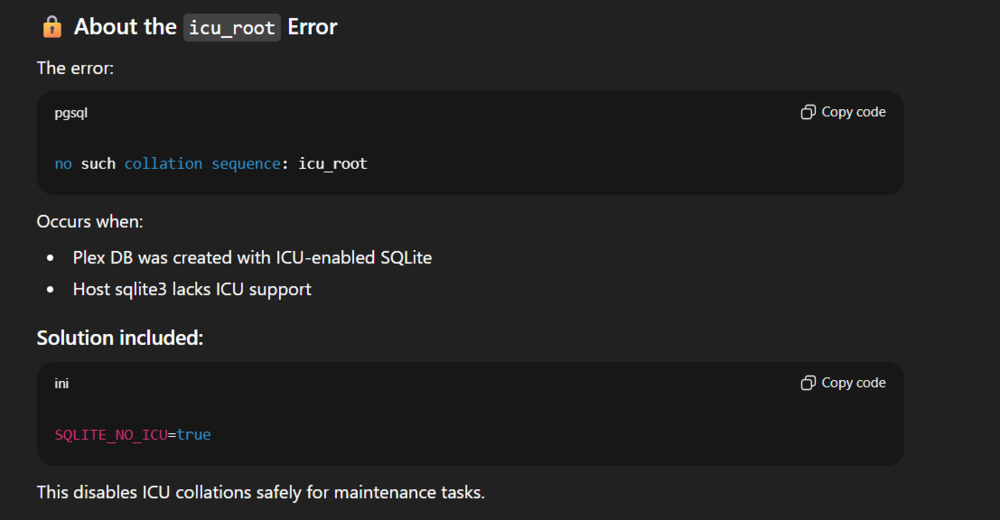

I tried all the DBREPAIR_MODE listed in your first post. All of them result in the same: Plex container is stopped, backup gets created, Plex is restarted. The repair script doesn't seem to run.
The only difference was with the 'check' DBREPAIR_MODE this outputs an extra error: Error: in prepare, no such collation sequence: icu_root. Tried this twice and same error occurs.
In this case also no backups are created.
[2026-01-13 16:04:00] ==================================================
[2026-01-13 16:04:00]  Plex DBRepair – Native Docker
[2026-01-13 16:04:00]  Mode                  : check
[2026-01-13 16:04:00]  Plex Root             : /plexmediaserver/Library/Application Support/Plex Media Server
[2026-01-13 16:04:00]  Databases             : /plexmediaserver/Library/Application Support/Plex Media Server/Plug-in Support/Databases
[2026-01-13 16:04:00]  SQLite                : /usr/bin/sqlite3
[2026-01-13 16:04:00]  Backup Dir            : /plexmediaserver/Library/Application Support/Plex Media Server/Plug-in Support/Databases/dbrepair-backups/2026-01-13_16-04-00
[2026-01-13 16:04:00]  Exclude Names         : dbrepair,plex-dbrepair
[2026-01-13 16:04:00]  Exclude Image Regex   : plex-dbrepair
[2026-01-13 16:04:00] Scanning for Plex containers to stop (match: Plex-Media-Server)
[2026-01-13 16:04:00] Skipping (excluded name): dbrepair
[2026-01-13 16:04:00] Stopping Plex container: Plex-Media-Server (d2c15ce7fe52) image=plexinc/pms-docker:beta
[2026-01-13 16:04:06] Check: com.plexapp.plugins.library.db
[2026-01-13 16:04:06] Restarting Plex containers that were stopped...

[2026-01-14 09:48:40] ==================================================
[2026-01-14 09:48:40]  Plex DBRepair – Native Docker
[2026-01-14 09:48:40]  Mode                : automatic
[2026-01-14 09:48:40]  Plex Root           : /config/Library/Application Support/Plex Media Server
[2026-01-14 09:48:40]  Databases           : /config/Library/Application Support/Plex Media Server/Plug-in Support/Databases
[2026-01-14 09:48:40]  SQLite              : /usr/lib/plexmediaserver/Plex SQLite (plex)
[2026-01-14 09:48:40]  Backups Enabled     : true
[2026-01-14 09:48:40]  Restore Last Backup : false
[2026-01-14 09:48:40]  Stopping Plex containers (match: Plex-Media-Server)
[2026-01-14 09:48:40] Skipping excluded container: dbrepair
[2026-01-14 09:48:40] Stopping Plex container: Plex-Media-Server (d2c15ce7fe52)
[2026-01-14 09:48:47] ==================================================
[2026-01-14 09:48:47]  Automatic (check → vacuum → reindex)
[2026-01-14 09:48:47]  Backup databases
[2026-01-14 09:48:47] Backup   : com.plexapp.plugins.library.db
[2026-01-14 09:48:47] Backup   : com.plexapp.plugins.library.blobs.db
[2026-01-14 09:48:47] Backup dir: /config/Library/Application Support/Plex Media Server/Plug-in Support/Databases/dbrepair-backups/2026-01-14_09-48-40 (2 file(s))
[2026-01-14 09:48:47] Check    : com.plexapp.plugins.library.db
ok
[2026-01-14 09:48:50] Check    : com.plexapp.plugins.library.blobs.db
ok
[2026-01-14 09:48:52] Vacuum   : com.plexapp.plugins.library.db
[2026-01-14 09:48:54] Vacuum   : com.plexapp.plugins.library.blobs.db
[2026-01-14 09:48:56] Reindex  : com.plexapp.plugins.library.db
[2026-01-14 09:48:58] Reindex  : com.plexapp.plugins.library.blobs.db
[2026-01-14 09:48:58] ==================================================
[2026-01-14 09:48:58]  DBRepair completed
[2026-01-14 09:48:58]  Log     : /config/Library/Application Support/Plex Media Server/Plug-in Support/Databases/dbrepair-docker-2026-01-14_09-48-40.log
[2026-01-14 09:48:58]  Backups : /config/Library/Application Support/Plex Media Server/Plug-in Support/Databases/dbrepair-backups
[2026-01-14 09:48:58]  Restarting Plex containers
[2026-01-14 09:48:59] Started: d2c15ce7fe52
