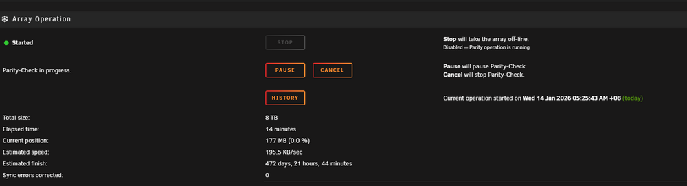

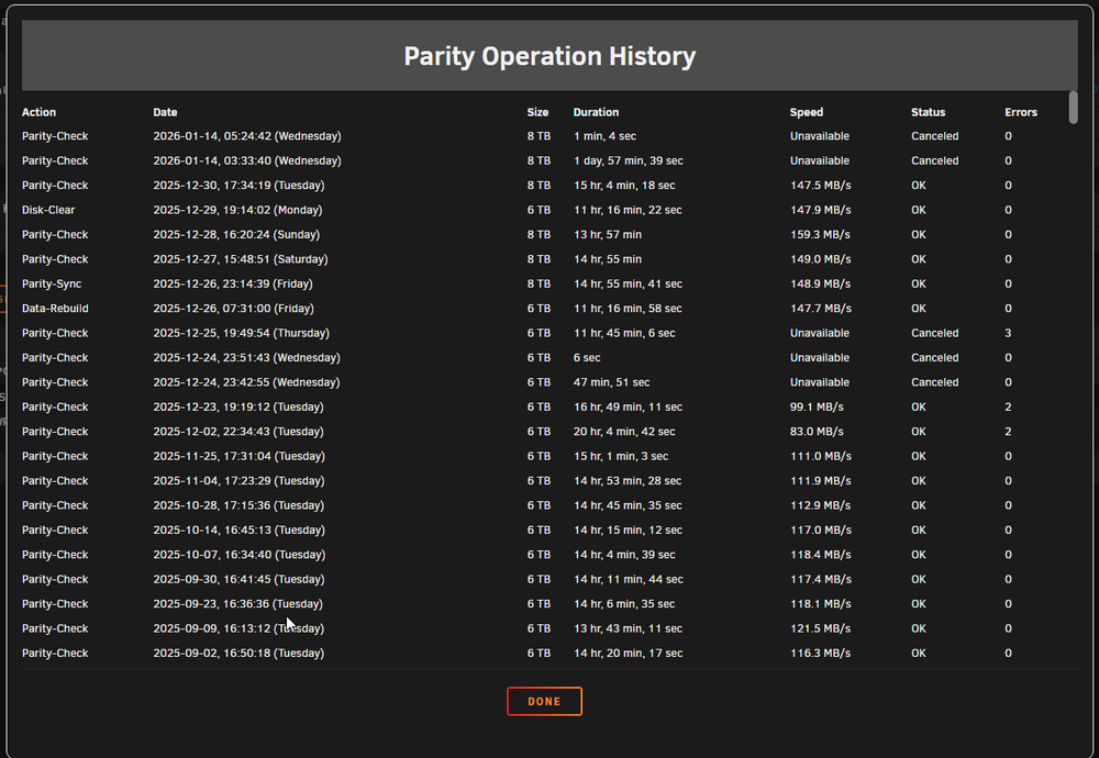

Hi, I am having an issue where my parity check speed is in KB/s instead of MB/s. It is normally at 140MB/s but currently it runs at 188 KB/s.
Here is the screenshot of history speed
The current Speed

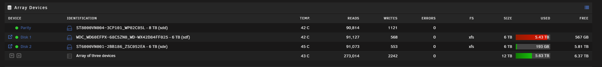

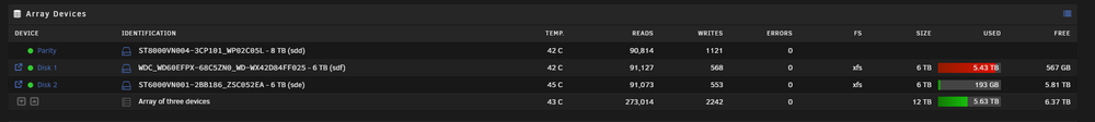

Parity disk looks OK, but it has connection problems.
On Main - Array Devices, are you not seeing ERRORs for Parity?
