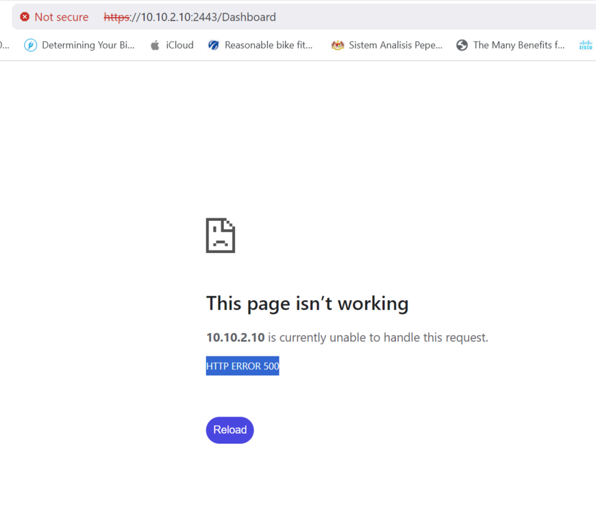

Page not working HTTP ERROR 500
Hi this two day i encounter this issue suddenly i cant login after the server are up for a while and i need to SSH into the server and do a reboot and everything are working again.
Attach are the diagnostic file and hope that the issue is been log.
image.pngts-p500-diagnostics-20260115-1531.zip

OK, don't see any issues in the syslog, but do see in the php.log:
PHP Fatal error: Uncaught TypeError: extract(): Argument #1 ($array) must be of type array, false given
in /usr/local/emhttp/plugins/dynamix/template.php:50
This suggests a plugin issue causing a problem with Dynamix, see if it hapens in safe mode.

Oooh. any idea which plugin? because i dont have much plugin install.
You have more than 20, I wouldn't call that not much.
If you don't want to try safe mode, remove half the plugins and test; if the same, try the other half.
