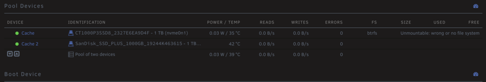

January 18Jan 18 I was working on a installing a new flash drive and installing a PIKVM and after getting both of those set up, I now can't get my cache drives to work as they are unmountable. theoasis-diagnostics-20260117-1844.zip

January 18Jan 18 Community Expert Solution btrfs was detecting data corruption on both devices, and you have a Ryzen with overclocked RAM, which is known to cause data corruption, so I recommend correcting that first:https://forums.unraid.net/topic/46802-faq-for-unraid-v6/page/2/#findComment-819173After that, it's still a good idea to run memtest, in case the RAM is actually bad, and then there are some recovery options you can try for the pool here:https://forums.unraid.net/topic/46802-faq-for-unraid-v6/page/2/#findComment-543490
January 18Jan 18 Author 13 hours ago, JorgeB said:btrfs was detecting data corruption on both devices, and you have a Ryzen with overclocked RAM, which is known to cause data corruption, so I recommend correcting that first:https://forums.unraid.net/topic/46802-faq-for-unraid-v6/page/2/#findComment-819173After that, it's still a good idea to run memtest, in case the RAM is actually bad, and then there are some recovery options you can try for the pool here:https://forums.unraid.net/topic/46802-faq-for-unraid-v6/page/2/#findComment-543490I did have a ram stick fail memtest but I haven't had any success with the other options to recover the pool Edit: did eventually get it to work. Thank you! Edited January 19Jan 19 by Easton Baker
