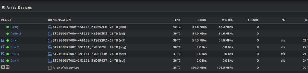

Here's the results of a copy process writing a group of 100 2 GB files to the array from another computer over the network. Everything else is idle on the Unraid system. The sending computer is not CPU limited or network limited.
I'm curious why the read rate is about the same as the write rate? Is that expected?
Diagnostics attached: t440-diagnostics-20260118-1201.zip
Yes, this is the typical write speed to a parity enabled Array. Each write requires a read of the data drive being written and the parity drive(s), a parity calculation, then a write to the data drive and parity drives(s).
If you have a cache set up for the Share being written, it does "speed up" the write access time - But just to make your "While you wait" at the keyboard time go more quickly. The write speed will be the same when the Mover transfers the data from Cache -> Array.

In your original post the screenshot showed your array writes to be just over 50MB/s, which I replied is pretty typical (and aligned with what I see on my server).
Ignoring what AI told you (as its answer doesn't directly answer what you are seeing), 20MB/s is not typical. Things that can influence this are other activity taking place on the array (reads or writes from another source/application) or something related to your source (you mention coming from a VM).
I would try copying a fairly large file internally on the server, such as from a pool drive (SSD/NVMe) to the array, using the native Unraid file utilities. This would help narrow down if the issue is you array or the mechanism trying to copy data.
The first screen shows normal speed for non turbo write, post a new screen with turbo write enabled (reconstruct write) while writing a large file.
