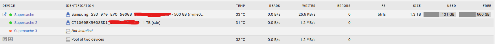

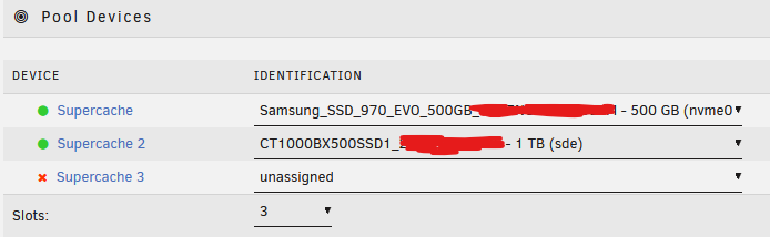

January 20Jan 20 I am a relative newbie to Unraid - ~one month of use - so please bear with me. I've luckily not lost any data - yet.My issues started a few days ago when I updated from 7.1.4 to 7.2.3. I had three devices in my cache pool for a total of 1.3 TB usable space - however, one was an NVMe in an external enclosure. Updating to 7.2.3 broke this. Since then, my pool has shown three devices despite only two being active. It's also still mis-calculating the total size available in the pool.I've attempted to remove the missing drive to no avail. When I stop the pool, drive three shows as unassigned. However there is no way to remove this from the gui. When I try to drop the pool slots from 3 to 2, it corrupts my /boot/config/pools folder to the point where the system is inaccessible through the webgui. When it's in this state the device does boot fine and I am able to load into safe mode with gui (no plugins), but the webgui still won't work. After spending most of the day troubleshooting what exactly is wrong, I've narrowed it down to an issue with php-fpm.sock which is causing the webgui to not load, and it's resolved anytime i clear my /boot/config/pools folder. All because of the missing pool drive that I'm no longer able to use because it was technically seen as a USB drive.I'm wondering if this is a bug with 7.2.3 for pool devices that are no longer valid if the system has been upgraded from 7.1.4 or lower. I'm also looking for some assistance with cleanly removing this missing drive so as to not cause any future issues. As I mentioned, I have not lost any data yet, but until all references to this unassigned drive are removed I'm afraid the pools folder can be corrupted at any point. Thank you for your time and any assistance you may be able to provide. Edited January 20Jan 20 by brownbe

January 21Jan 21 Solution First, note that the pool will only have 500G usable with those two devices in raid1.You should be able to remove the missing device using the CLI, with the array running typebtrfs dev remove missing /mnt/supercacheOnce that finishes and you get the cursor back, you need to reimport the pool with the two remaining devices:on main click on the first device for that pool and then "remove pool"back on main, create a new pool with the same name and 2 slotsassign the two pool devices, leave the filesystem set to autostart the array to import the pool
January 21Jan 21 Author 5 hours ago, JorgeB said:First, note that the pool will only have 500G usable with those two devices in raid1.You should be able to remove the missing device using the CLI, with the array running typebtrfs dev remove missing /mnt/supercacheOnce that finishes and you get the cursor back, you need to reimport the pool with the two remaining devices:on main click on the first device for that pool and then "remove pool"back on main, create a new pool with the same name and 2 slotsassign the two pool devices, leave the filesystem set to autostart the array to import the poolExcellent, that appears to have worked. Thank you! One quick follow up - if I wanted to replace the 500 GB drive with a 1 TB drive, would I just follow the same steps to "remove pool", swap the drive, then let the replacement rebuild off the remaining drive?Edit:Since I've performed a number of unclean shutdowns, I went ahead with a balance and a scrub of the pool. I checked the filesystem health and have some errors. Should I repair it? (UUID sanitized) [1/8] checking log skipped (none written) [2/8] checking root items [3/8] checking extents [4/8] checking free space tree We have a space info key for a block group that doesn't exist [5/8] checking fs roots [6/8] checking only csums items (without verifying data) [7/8] checking root refs [8/8] checking quota groups skipped (not enabled on this FS) Opening filesystem to check... Checking filesystem on /dev/nvme0n1p1 UUID: XXXXXXXX-XXXX-XXXX-XXXX-XXXXXXXXXXXX found 38649397251 bytes used, error(s) found total csum bytes: 36361904 total tree bytes: 999817216 total fs tree bytes: 904364032 total extent tree bytes: 56295424 btree space waste bytes: 173121053 file data blocks allocated: 61859446784 referenced 47771791360 Edited January 21Jan 21 by brownbe
