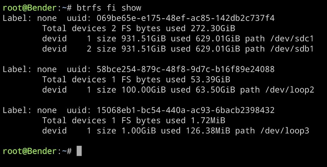

Please post the output from btrfs fi show
Doesn't seem to show the 2tb nvme, only my two mirrored 1tb drives?
I won't have access to a computer until later so here's a screenshot from my phone, I can't seem to be able to copy paste from the terminal on it.
Yep, no valid btrfs filesystem being detected on that device. When you can, post output from:

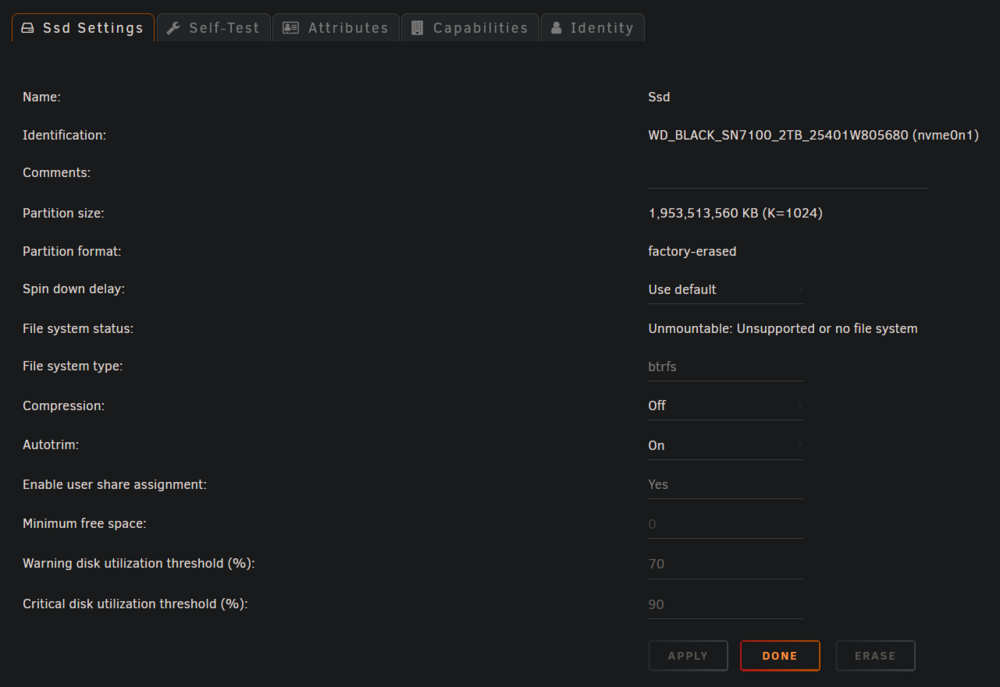

Yes it should be btrfs, it says so as well in the drive settings
