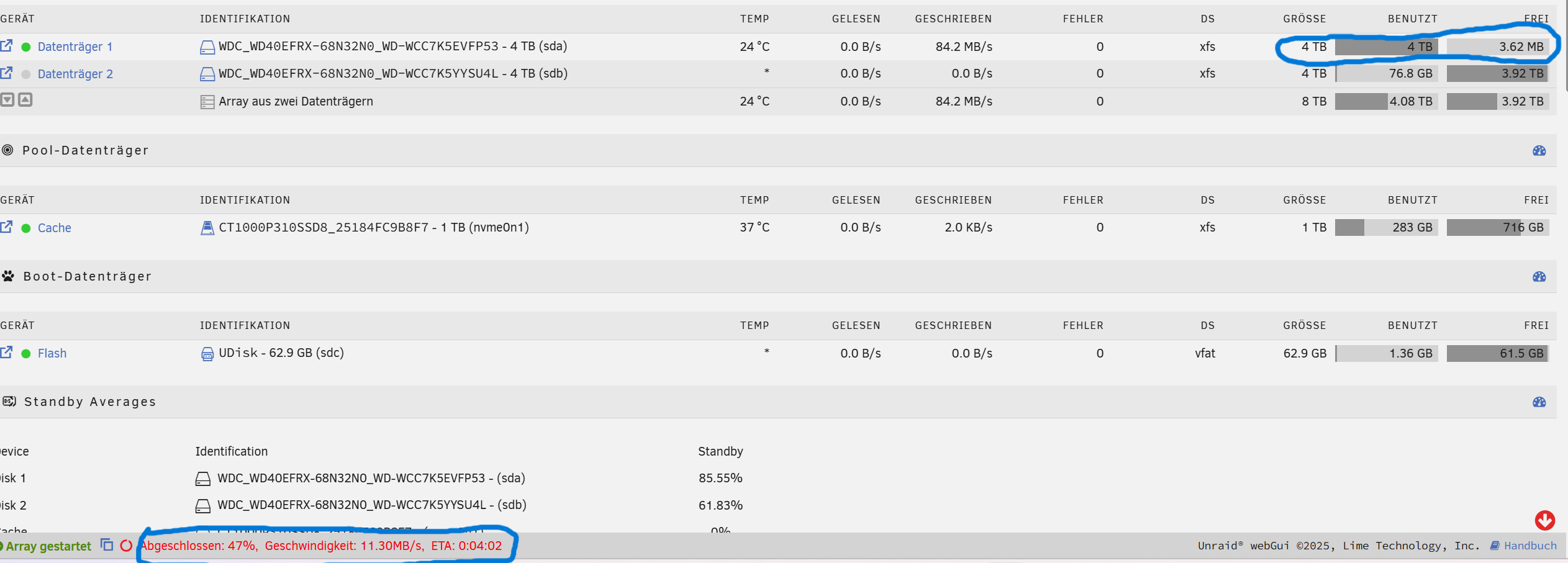

I added a second hdd to my array. I use high water and automatic split for each share (this is what I found in the forums what solved problems for others).
Then i added a lot of data from my Qnap NAS.
As you can see in the screenshot disk1 is running out of space and disk 2 won't be used.
At last I tried to transfer a single file but it stopped at 47% because disk 1 is full. Disk 2 won't even wake up (but it does when clicked).
Hope someone can help me please...

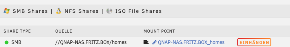

How exactly are you doing this?
I mounted the Qnap share as SMB share and copied/moved via unraids filemanager to the unraid share..Screenshot 2026-01-24 200104.png

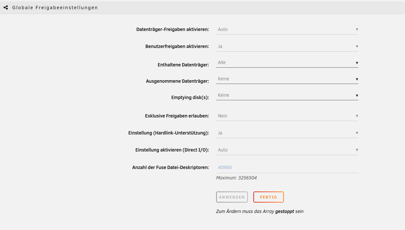

Post a screenshot of Global Share Settings

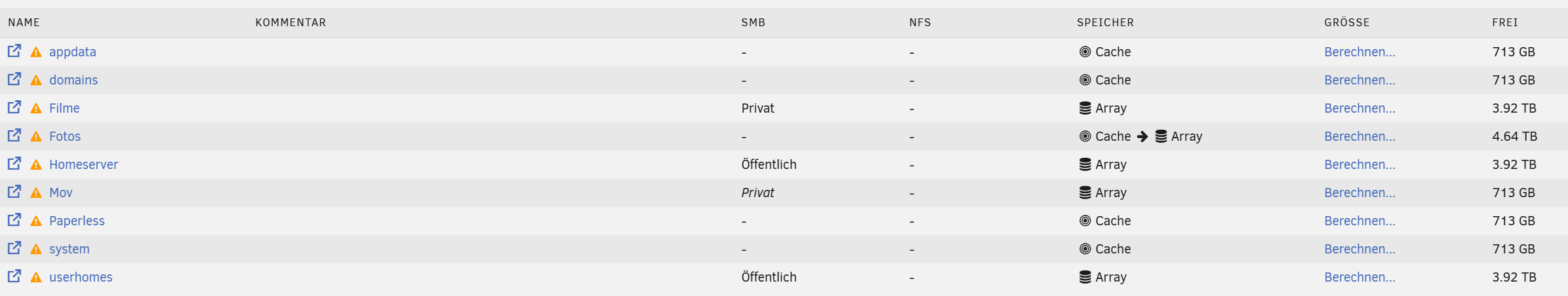

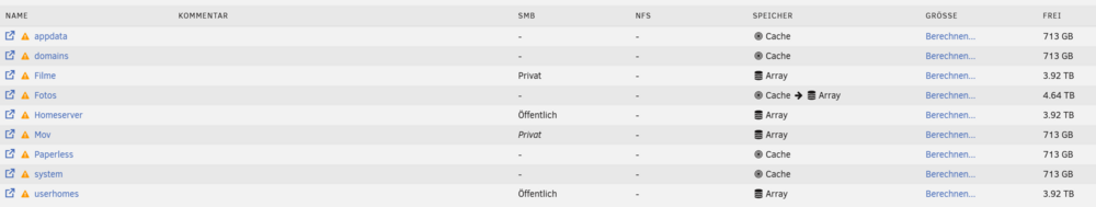

OK here are the shares and the global share settings.
Anything strange there?

What user share are you writing to?
to "Mov"...
