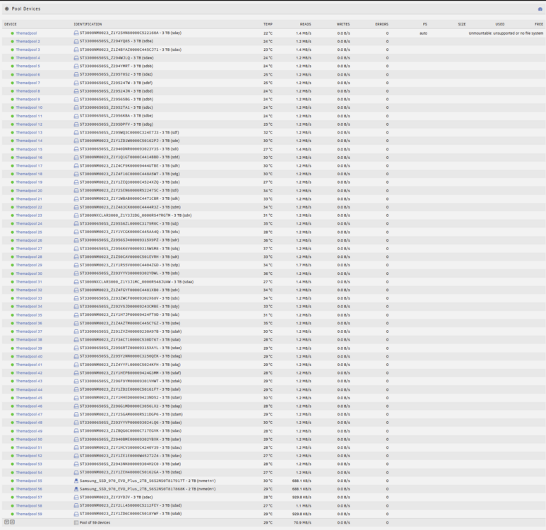

I am wanting to migrate from Truenas Scale to Unraid 7.2.3.
I'm using the temporary 30 day trial to confirm that this works, but do plan on buying it once everything is up and running.
I'm having issues importing my existing 57 3TB HDDs (Raidz2 9x6 and 3 Hot Spares) and 2 2TB SSDs for Cache
I've created a 59 slot pool and left everything on auto/default and then placed in all of my drives, but when I go to start the array it leaves me with "Unmountable: unsupported or no file system"
The pool is encrypted and I haven't put in my key anywhere so I was thinking that might be part of the reason?
Solved by Kilrah

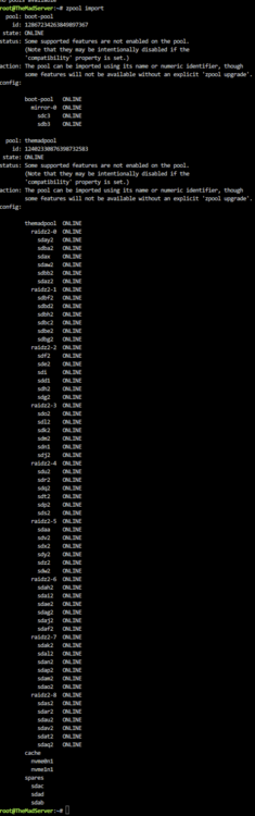

I usually have to run the terminal manual commands first before you even attempting to add disk pools to unraid to do an import from Truenas to unlaid.
With the pool completely deleted, are you able to run the command ZFS list
And ZFs import
To see if the disk can even be imported.
I am able to zpool import the pool, but from what other similar instances I could find everyone told them to zpool export the pool before starting the array so I've always done that.
Unraid doesn't currently support zfs spares; you would need to remove them and reimport the pool without them.
Doesn't support ZFS native encryption either, right?
Correct, if that's being used, the pool won't be imported by the GUI.
I've removed the spares and for simplicity the cache as well.
Looking into ways to recreate the pool without encryption while not losing any data. The pool is currently at 39% capacity and using all available HDDs so I have nowhere I can temporarily move the data to.
Was able to take advantage of my Raidz2 setup and yoinked drives from the existing pool without losing data to make a new pool.
Setup a new pool (without encryption) and was able to get unraid setup on it. Technically ended up not importing an existing pool, but thanks for all help anyways.
