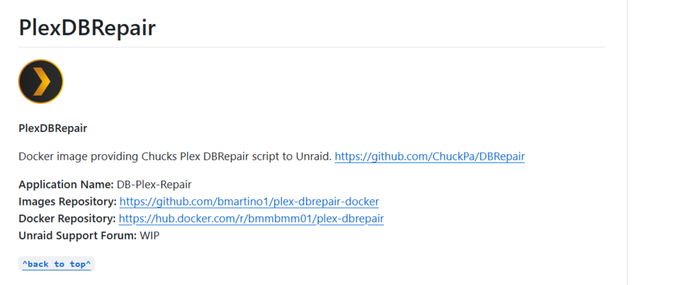

Here is an reference example from documentation:

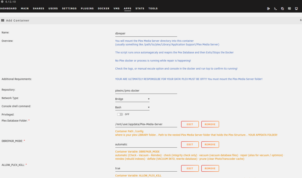

I am going to change Repository to plexinc/pms-docker as in this document, right? Is the any other settings that need to be changed other Plex Database Folder, to into this unraid docker app?

Correct

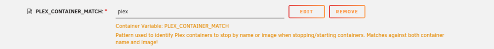

as that tells the docker to kill teh corect plex if its not stoped more a safety net catch all but its best to use the repo to guarantee that docker only is stoped. leaving as plex will intaite a search so anything with the word plex will be killed / stoped...
the tricky part is settign the please database path, which should mirror your appdata folder.

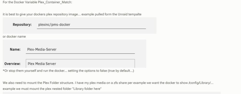

This is an example in document:

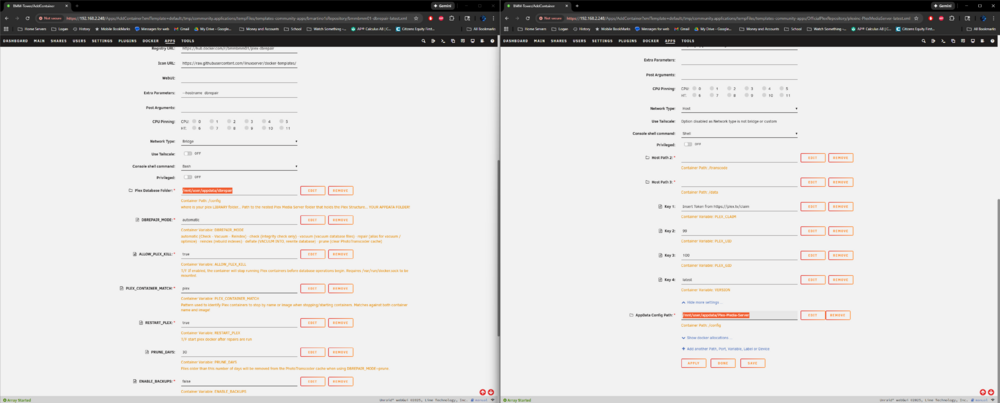

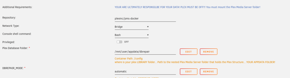

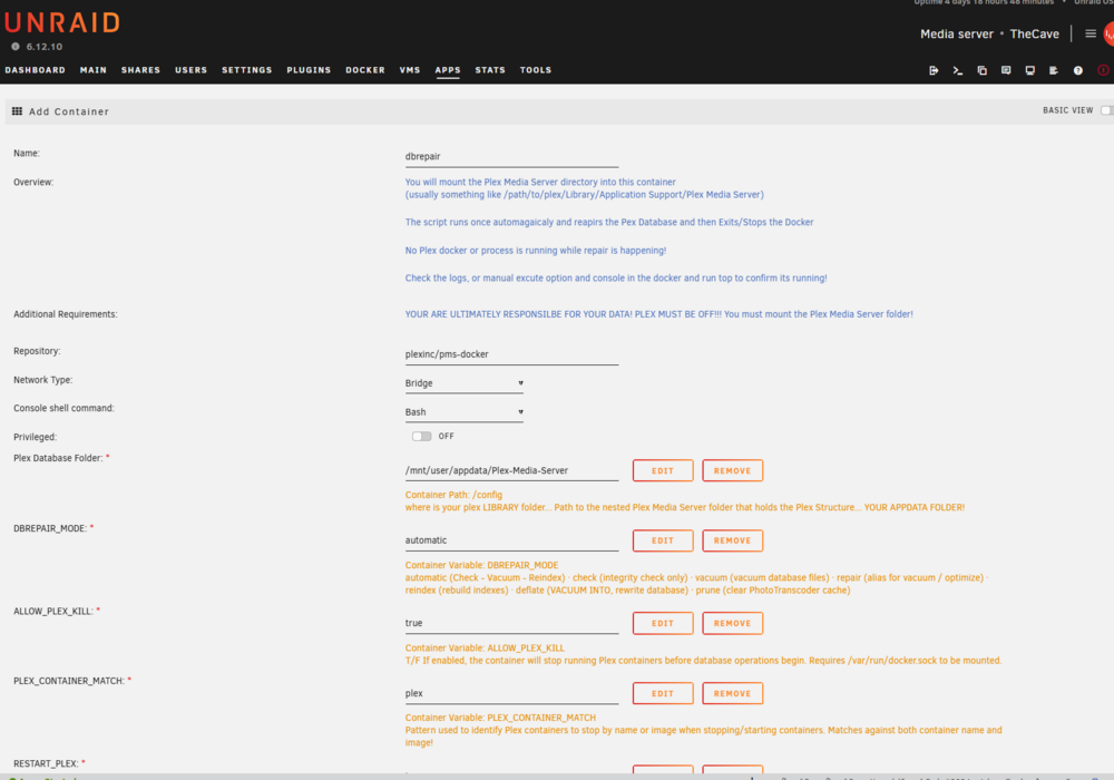

This is my dbrepair docker install setting before install process.

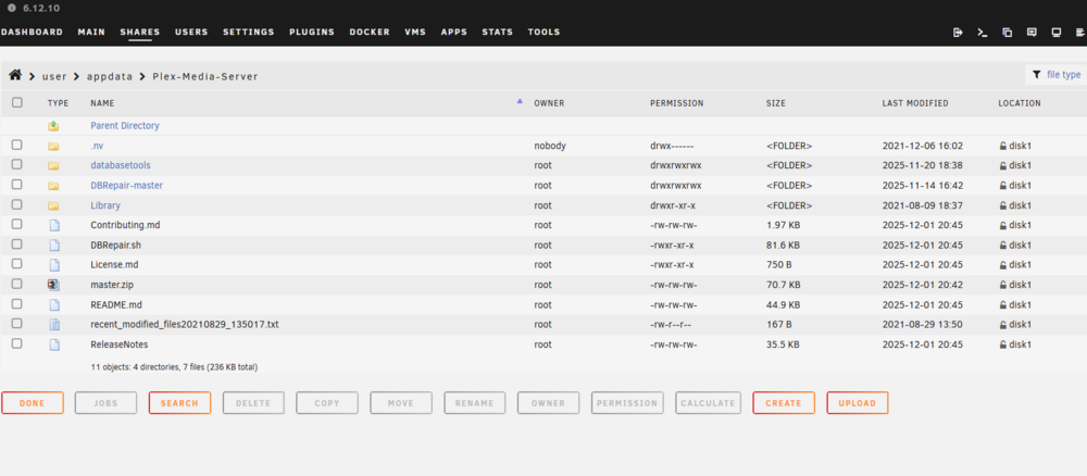

This is my shares view. Please note you will see DBRepair there already. This is because I started to do some steps manually ( 2 weeks ago). Did some prep, but did not run dbrepair. Just could not figure out the proper execution for plexinc-docker. Just wanted to confirm the correct path to install dbrepair docker correctly. Please see below.
I hope everything made sense. I am just installing the dbrepair app on my Uraid server. On the second page of the install page setting parameters I need to confirm the correct settings. This is the correct path to use, right?
/mnt/user/appdata/PlexMediaServer
Think I am ready to continue, right?
yes, looks good
if you cd /mnt/user/appdata/Plex-Media-Server
and run command ls to list the contents
You should see a "Library" folder. If yes, then that's correct!
root@BMM-Tower:/mnt/vm-zfs/Dockers/Plex/database# ls
DBRepair.sh* Library/

the repositoy it self is wrong you don't change the repository at the top that the docker tag you pull
bmmbmm01/plex-dbrepair
repostiry should never change..
That repository needs to go here:
replace plex with the repository tag you have...

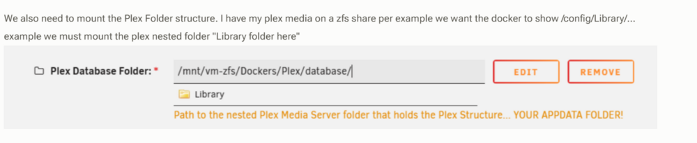

as in thoery the only thing you frealy have to do is add teh appdata folder to the plex Library and click apply no other chnages should be necessay to run a automatic repair...

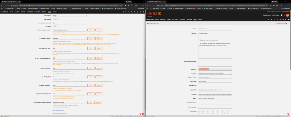

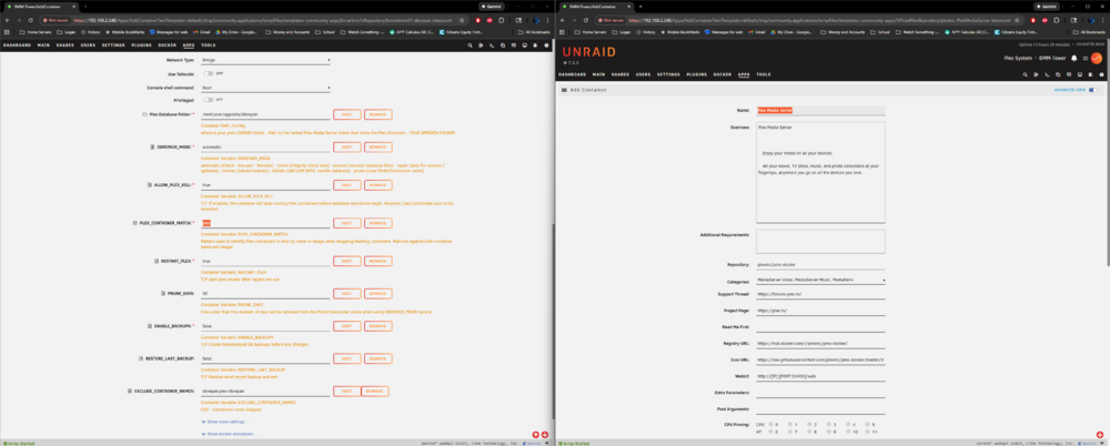

what I recomend is opening 2 web pages in unraid...
this way we can grab the data needed...
so in one page be at teh dm repair install page noted on teh left. and edit your plex docker to grab the needed data form the right...
example:
Step 1 set the Plex folder path:

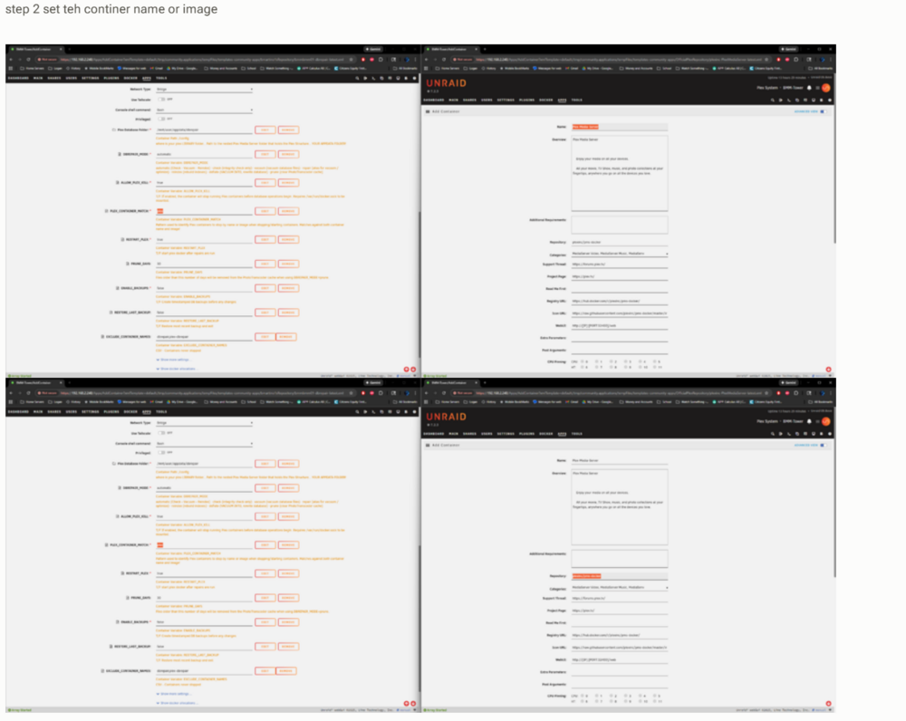

OPTIONAL / Recomend step 2 set the container name or image
OR
thats it... run my docker dbrepair...

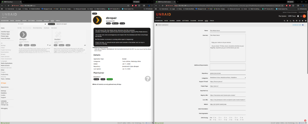

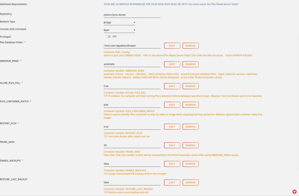

Sorry, I am confused. So I selected to install dbrepair app on unraid, then I get the following page in the install process:
I should not update this page ?
Okay I see your new information now.. I will look at it now.
Oh I am following your steps fine. Maybe I am missing something. Just wondering about step 2. Plex_Container_Match, Left top and bottom screen are the same. But the right top and bottom are different highlighted values . What should the Plex_Container_Match be the name or the repository value?
either or pick one. this is how my docker identifes the plex continer. by default it will search unraids dockers for anythign conting plex
I recomend using the repository image as its a direct this one and kill.
the issue you have atm is your calling a plex docker image and not my docker image:

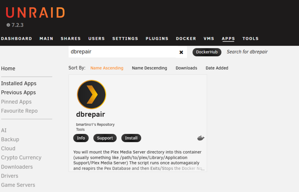

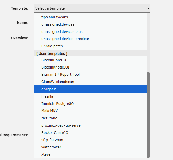

you may need to delte your cuirent tempate and reinstall per teh CA Docker template:
go to
select teh template:
and hit the x to remove the tempalte:
then go to the apps page and install... Your making this more complcated then it actual is...

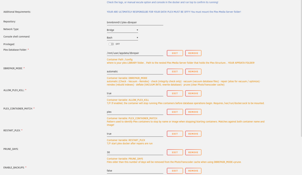

SO AGAIN! So the plex match is litelr a "filter" of words to find what the filter catches and dockers to kill so the plex docker to ensure it is stoped. AS YOU WILL BREAK PLEX IF ITS ON AND THIS CONECT TO THE DATBASE TO REPAIR!!!
ALL it does, by this setting islooking for anything with "plex" per docker ps and KILL IT! so no plex is NOT running!

the unraid temaptel based on your edits NEEDS TO BE DESTORYED AND INSTALLED default settings... with only 1 change...

based on the unraid tmplate I've done a lot of YOu can't mess this up scripting in this docker... As IT will auto map the unraid docker sock to connect to be able to kil dockers, This will auto filter and kill any and all things named plex (with safe guards to not killl itself as the dbrepair image is called plex-dbrepair)...
This will auto run the dbreapir automatic unless you change the variables... LIKE DID YOU EVEN READ THE ORANGE! or tempate settings...
just set the appdata and click apply this auto does EVERYTHING FOR YOU! You ONLY AND just need to set the DB folder to the plex Libray folder... thats it...
PER YOOUR POST AND DATA HERE this should be:
Otherwise YOU HAVE A DIFFENT DAT PATH TO THE DATABASE!
SO RECAP!!!
DEFUALT TEMPTE INSTALL CHANGE ONLY THIS!!! AND NOTHING ELSE!
CLICK APPLY
then open the docker/ continaer log of dbrepair... as THIS RUNS THE SCRIPT AND DBREPAIR APP!!!! LET it finish...
dbreapir automaticaly will run and repair the plex database...
See LOG THAT IT!
I litterly can't make it any simpler.... Ialso Can't gurantee a dbrepair will fix your isseus given basic docker and unraid tempatle setups... given teh issues here...
To assist further, I will not be back... Please Post the docker your trying to repaire SCREENSHOTS! and MY DOCKER LOGS based on the log I can infomr you what happened....!
Then i can assit further... as You shouldn't have to supply the plex OR EDIT THE repo... its recomen so only that gets killed. as if you have plex or if plex is in any other docker this Docker will KILL THEM! That all
