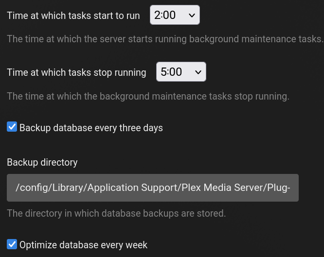

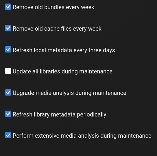

What do you have in Plex Settings for Scheduled Tasks?
A database backup from 2am to 5am to
/config/Library/Application Support/Plex Media Server/Plug-in Support/Databases
Some searching also tells me the optimize database checkmark could be causing issues? Unsure.

I noticed the docking filling up happens around the same time as my plex database backups happen early in the morning, but for the life of me I cannot find where it is saving these. I have /data mapped which I assumed would be enough, but I don't think it is. However I cannot figure out where these files are specifically to delete them, or what I need to change.
