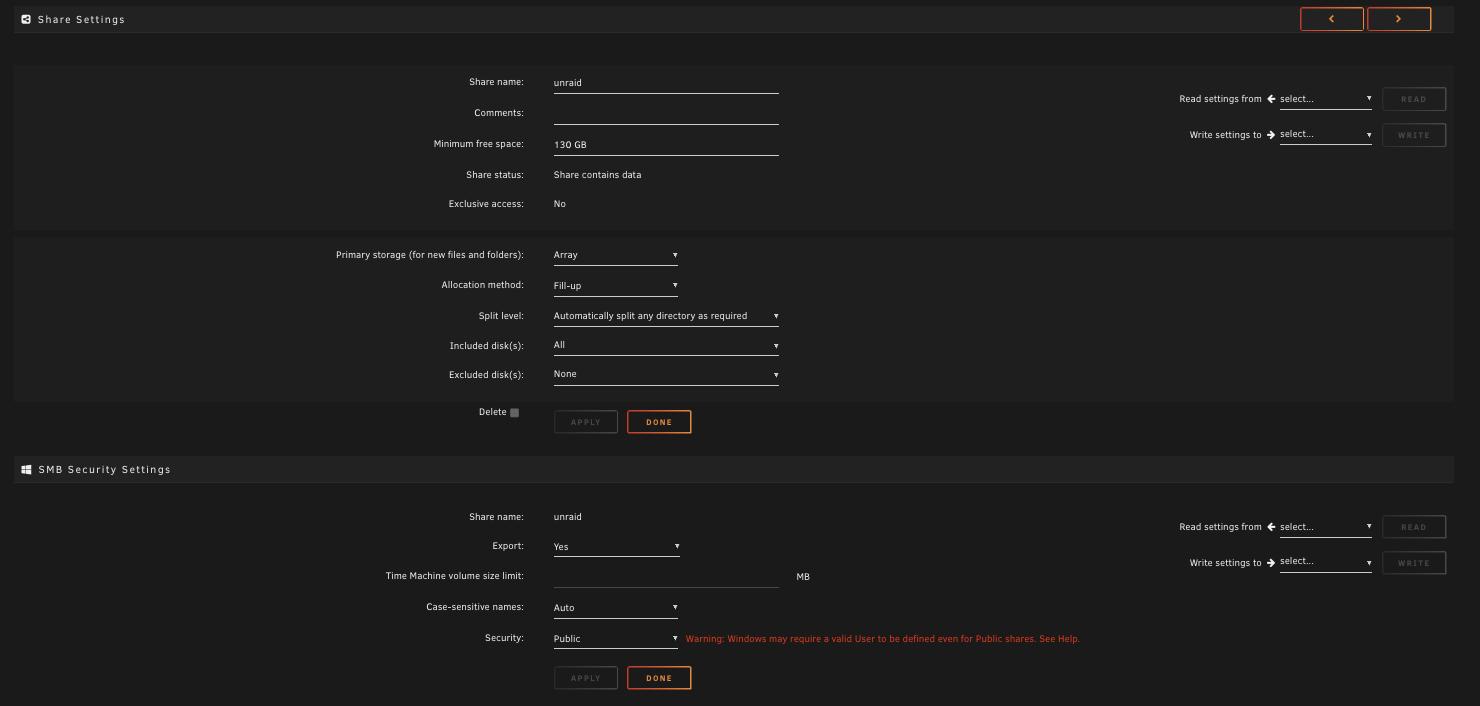

I have an SMB share to allow connecting to my Unraid share from a Windows PC (attached).

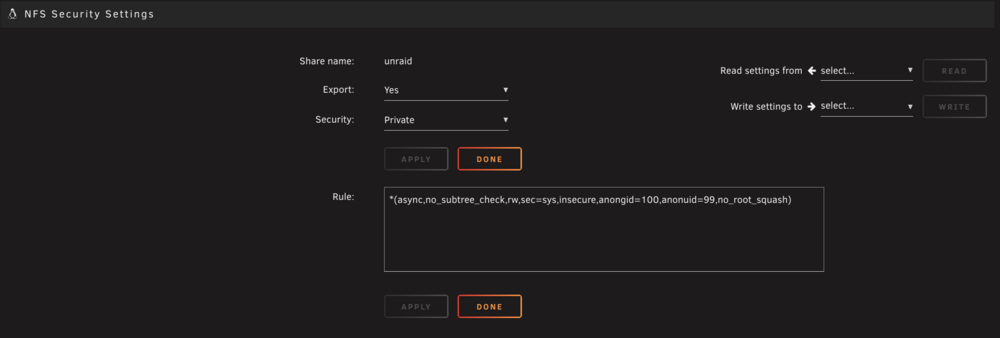

Configure NFS on Unraid
From this guide, I have set the rule to (attached):
*(async,no_subtree_check,rw,sec=sys,insecure,anongid=100,anonuid=99,no_root_squash)
Does the <star> replace the <ubuntu_ip> in your example? Should I specify the <ubuntu_ip> instead?
