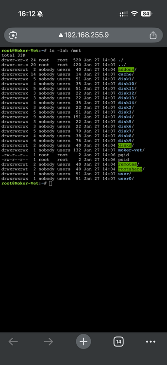

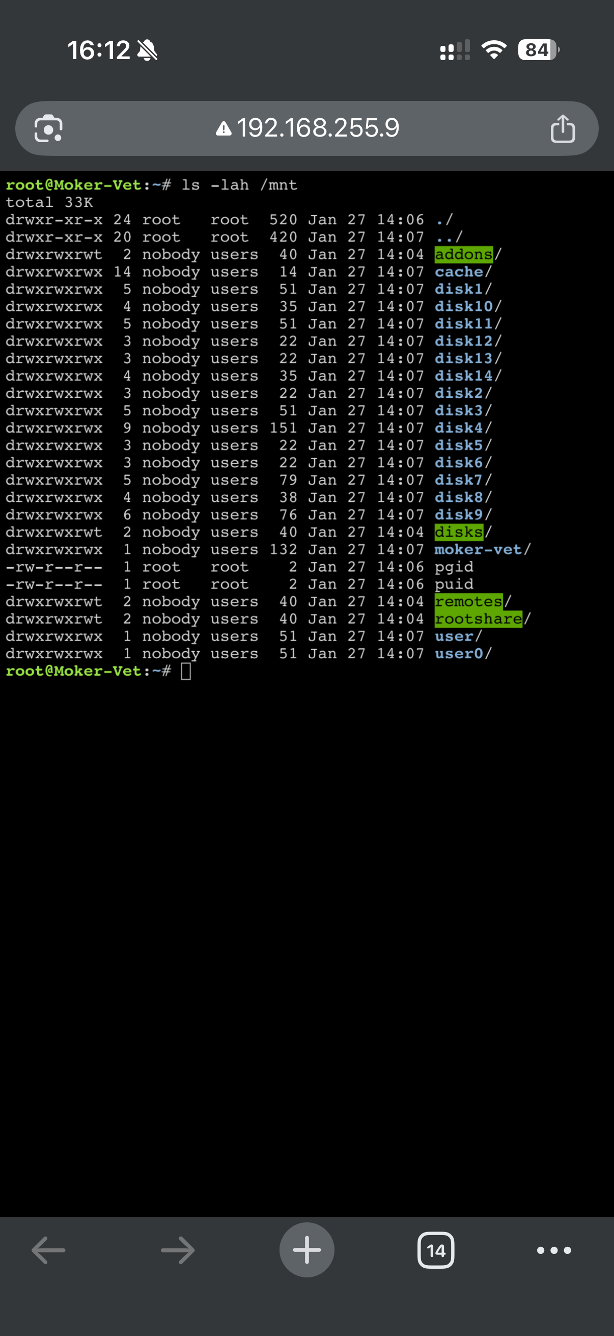

What do you get from command line with this?
ls -lah /mnt
See attached image. I also have found that my plex media server container is very slow loading in libraries. But i dont know if that is related or not..
Not taking up much space then (as expected) but still not good
