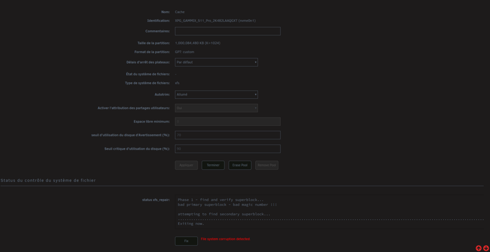

During the last restart, the cache disk became "unmountable", therefore no more VMs, no more Docker.
I therefore started the array in maintenance mode and tried to perform a repair -> failure.
Since the cache disk is 'unmountable', it also starts to disappear.
Do you have any ideas?

XPG_GAMMIX_S11_Pro_2K482LAAQGXT (nvme0n1) 512 2000409264 => data partition: nvme0n1p3 type: gpt start: 239616 size: 1000084480 code: 0xee (8)
Jan 28 00:49:50 NorthernLight root: mount: /mnt/cache: wrong fs type, bad option, bad superblock on /dev/nvme0n1p3, missing codepage or helper program, or other error.
Jan 28 00:49:50 NorthernLight root:        dmesg(1) may have more information after failed mount system call.
Jan 28 00:49:50 NorthernLight kernel: XFS (nvme0n1p3): Invalid superblock magic number
Jan 28 00:49:50 NorthernLight emhttpd: shcmd (96): exit status: 32
Jan 28 00:49:50 NorthernLight emhttpd: shcmd (97): rmdir /mnt/cache
Jan 28 00:49:50 NorthernLight emhttpd: cache: mount error: wrong or no file system
