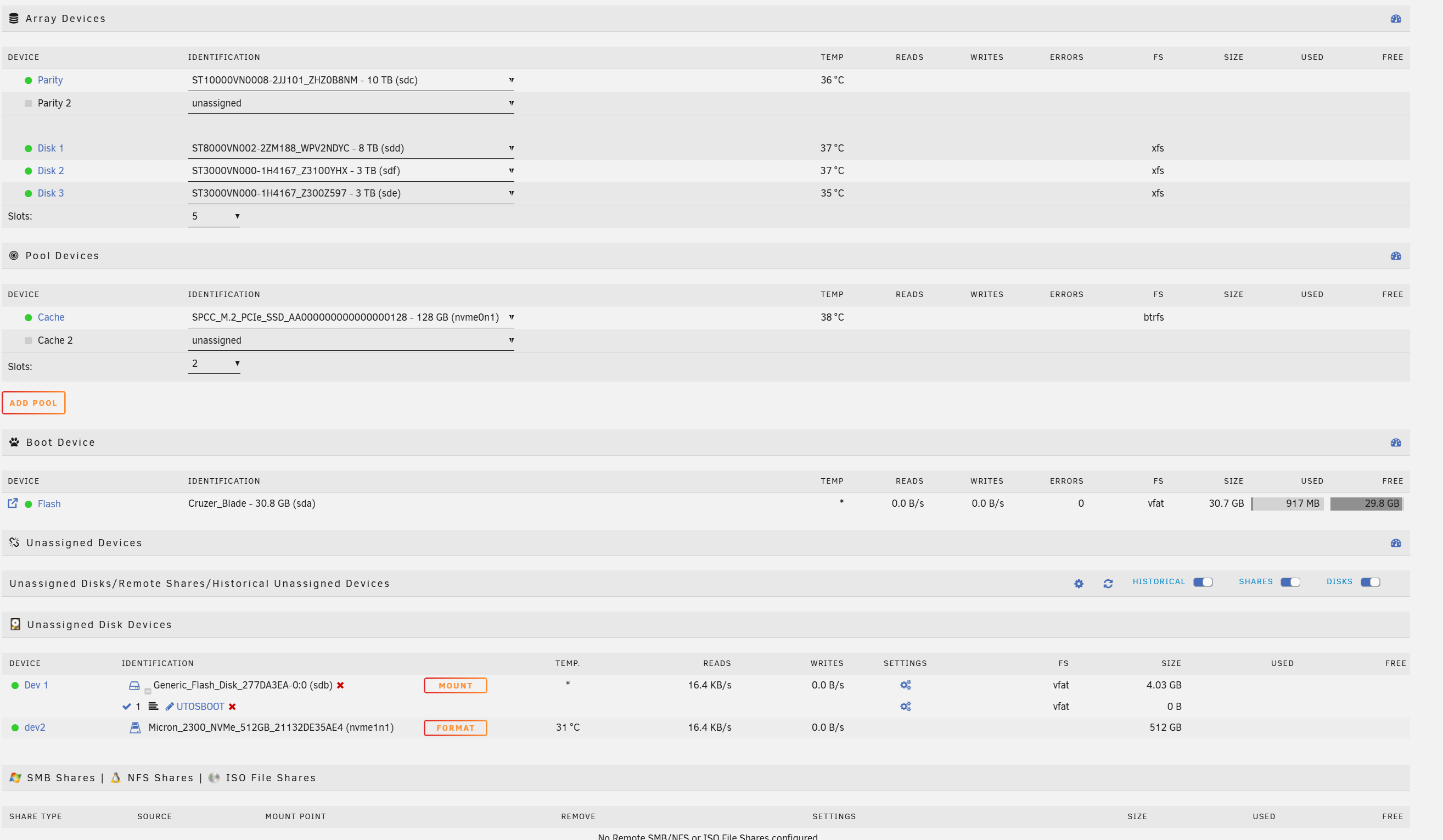

Over the starter device limit - does the boot USB count? or is it my configuration.
So I have the starter Licence.
I have 4 HDDs (3 drives, 1 parity), 1 NvMe as Cache, and the Usb with Unraid on it.
I've attached a 2nd NvMe for Cache, and I'm getting the unraid device limit.
Does the Usb count towards the limit? The other issue I have which ive never been able to figure out is in the Array size, the minimum i can select is 5 (cant go below 5), with 2 parity (1 of which ive left unassigned), and 3 disk drives.
Is the problem the USB? or is it that the array size is 5 and counting it as such, even though i only have 4 drives there)?
Nope, but there's another connected, and that one counts.
Thing is I only have the one usb connected, the usb drive with unraid in it. I have no idea where this is. I'm using a Terra master f424.
EDIT: Found the reason. theres an internal Terramaster TOS USB.

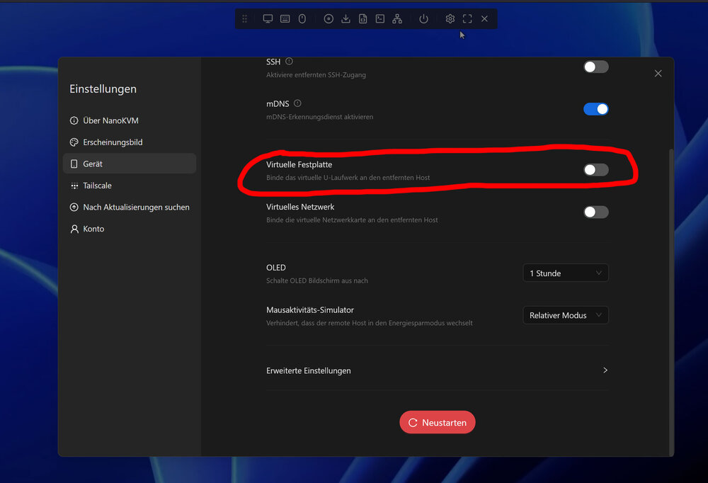

Sometimes devices like (USB) network cards, CD Roms and so on contain a 2nd partition shipping the needed drivers for that card.
Usually this is turned off once you have installed it under windows. This will obviously not work with UNRAID/Linux.
So there may be an additional drive that you are not aware of.
Check the USB devices.
(Aaah, also certain KVM devices like NANOkvm come with an storage device which allows you to flash bios or ship drivers. Usually you can find a setting to turn this off)
Probably need to either disconnect it if it's a physical USB or disable it in BIOS so unraid does not detect it
