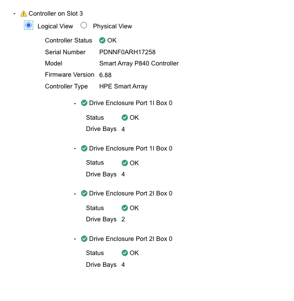

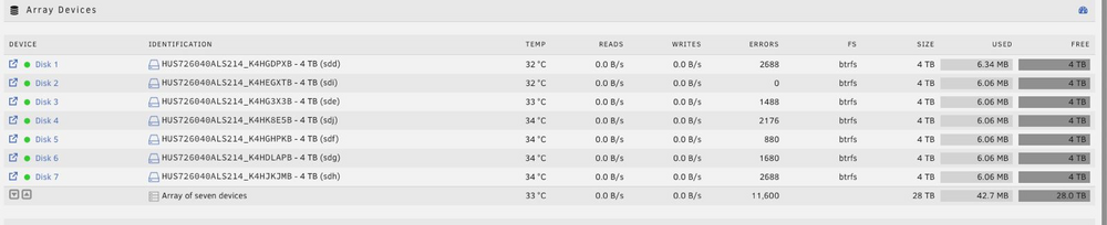

Image 1 added here proves that the array started with no problems. However, as soon as I start the check of the disks, I have a lot of errors, as image 2 shows (these numbers are just after 10 seconds of having the check running).
Any idea of what I'm missing or kind of problems and solutions that I have?

Syslog has these for multiple disks:
Jan 29 20:57:04 MMServer kernel: protection error, dev sdf, sector 210432 op 0x0:(READ) flags 0x0 phys_seg 72 prio class 0
Jan 29 20:57:04 MMServer kernel: md: disk5 read error, sector=210368
Jan 29 20:57:04 MMServer kernel: md: disk5 read error, sector=210376
Jan 29 20:57:05 MMServer kernel: protection error, dev sdg, sector 212480 op 0x0:(READ) flags 0x0 phys_seg 72 prio class 0
Jan 29 20:57:05 MMServer kernel: md: disk6 read error, sector=212416
Jan 29 20:57:05 MMServer kernel: md: disk6 read error, sector=212424
Jan 29 20:57:05 MMServer kernel: protection error, dev sdj, sector 207104 op 0x0:(READ) flags 0x0 phys_seg 232 prio class 0
Jan 29 20:57:05 MMServer kernel: md: disk4 read error, sector=207040
Jan 29 20:57:05 MMServer kernel: md: disk4 read error, sector=207048
Jan 29 20:57:06 MMServer kernel: protection error, dev sde, sector 205568 op 0x0:(READ) flags 0x0 phys_seg 168 prio class 0
Jan 29 20:57:06 MMServer kernel: md: disk3 read error, sector=205504
Jan 29 20:57:06 MMServer kernel: md: disk3 read error, sector=205512
Jan 29 20:57:06 MMServer kernel: protection error, dev sdd, sector 206336 op 0x0:(READ) flags 0x0 phys_seg 72 prio class 0
Jan 29 20:57:06 MMServer kernel: md: disk1 read error, sector=206272
Jan 29 20:57:06 MMServer kernel: md: disk1 read error, sector=206280
Jan 29 20:57:06 MMServer kernel: md: disk7 read error, sector=206848
Jan 29 20:57:06 MMServer kernel: md: disk7 read error, sector=206856

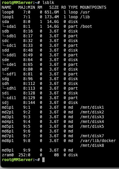

What do you get from command line with this?
lsblk
During my tests, I recreated the array, so I'm adding here what you requested but also the new diagnostics.zip.
Also, check the image with the disk errors that I described, and the other one with lsblk.

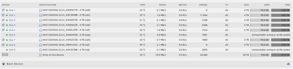

Can you format disks 6,9 using the webUI?
The option appear, I ask unraid to format it but still the same, with the same error in the image.

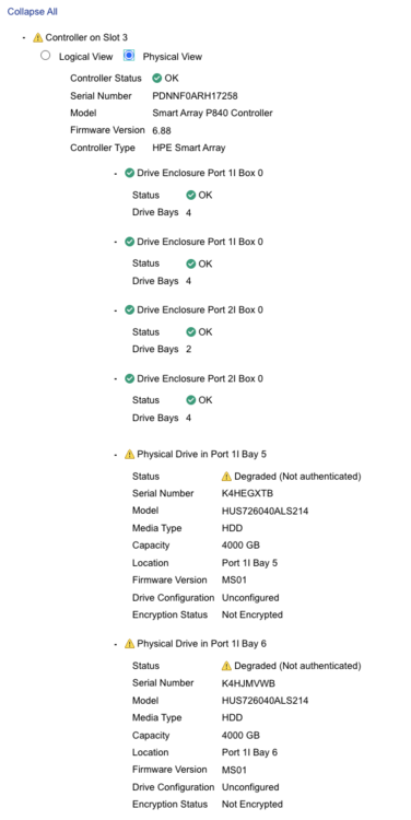

Are you sure?
Yes, I have no disks in Logical View, only in Physical View.
