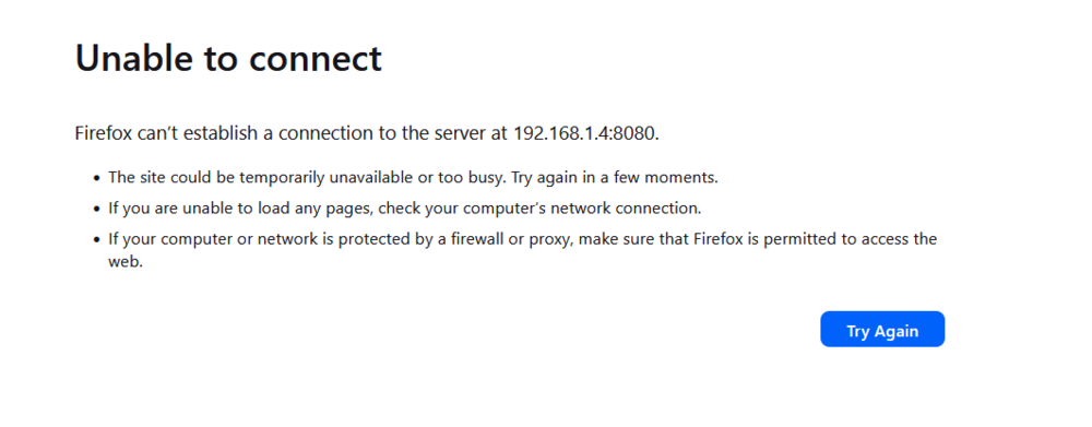

Hi all,
My cache drive failed and I replaced it and used Appdata backup to recover my dockers.
After re-installing them all, they appear to be working but I can't access any of them. It just says "Unable to connect".
Not really sure how to fix this.
Any advice would be appreciated.

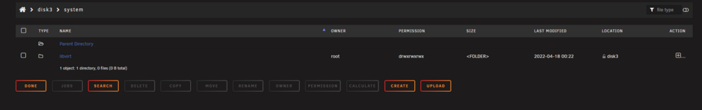

The usual cause of growing docker.img usage is an application writing to a path that isn't mapped.
What is in the system folder on disk3?
And what is in the system folder on cache?

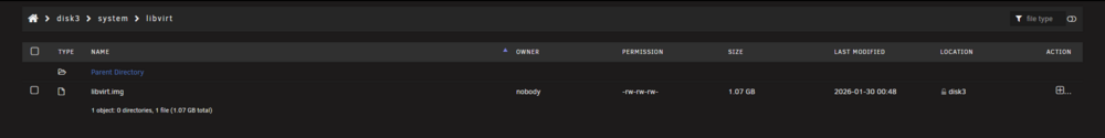

Just a folder called libvert
There is a large img file.
Edited by bobalot
More information

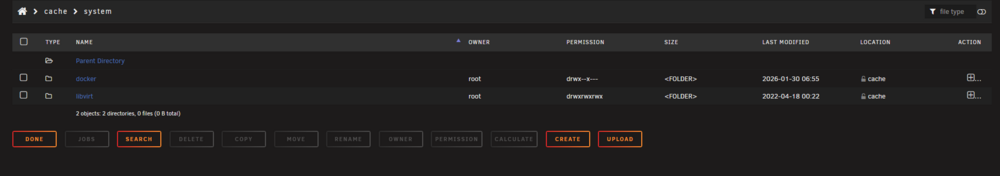

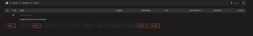

libvert is empty
That is the default size for libvirt.img
But it belongs on cache.
You will have to disable VM Manager before you can move it.
Of course, none of that has anything to do with your dockers, but still good to clean that up.
Is there anything in system/docker on disk3?
No system/docker folder on disk3 according to your screenshot.
How are you trying to go to the webUI of that container in the first post?
Are you clicking on its icon and selecting WebUI?
Is that from a monitor attached to the server, or from another computer on the network?
I just type in my IP on the network and the port.
It's from another computer on the network.
I just noticed that I can access my unmanic docker (which isn't on a custom network - not sure if that is relevant).
What happens like that?
That hasn't worked in Foldierview2 for a while (before the SSD failure, plugin needs the dev to update this bug) but I did try that in the apps menu for the dockers that were installed (selecting the docker and clicking webui) and it didn't work.
Been checking some other dockers, this issue seems to be limited to anything on the custom docker.
Weird. I thought I have VMs turned off.
Thanks. I have turned it off.
What happens if you remove that plugin? Can you click on the icon and select WebUI then?
I managed to fix some of them by changing the WebUI from http://[IP]:[PORT] to the hard coded address (192.168.1.4:XXXX).
It must have been that plugin. Had to go to work. When I get back from work, I'll remove it all together and see what happens.
Most of the dockers are accessible now. A few not working.
Not really sure why that plugin is causing and issue if it didn't before my old SSD failed.
