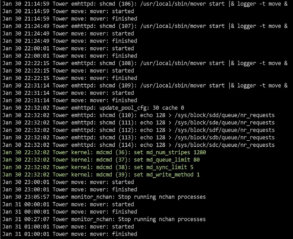

In the last few days new media moved onto the server was stuttering during playback. When I logged in I was greated with 10's of messages about the cache being full. Sure enough of the 3TB it has 2.88 sitting on it. Also I noted in the main screen the "thinking" wave is just going forever. I don't run any VM's and the only Docker is Plex. I set Plex to not auto restart and rebooted the tower. It came back up with Plex off and I manually selected to run the mover. As of now I have not seen any movement.
I only have three shares and they are specified to live on the array not the cache. Nothing is being transferred in or out with Plex off. But I have the thinking wave non stop.
Any ideas what is going on?
I also pulled up the logs just now and I see that when I execute the move, in the same second the log shows it completed. I can see my scheduled hourly moves try to happen.

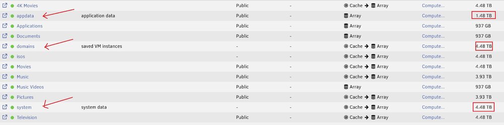

So these three? I just don't know how this all works when their sizes show as way larger than my Cache drive.
The minimum free cache field is greyed out on the drive. If there some other setting I need to activate to make that field active?
Those are not the size, the numbers are the Free Space (says so at the top but you have clipped the top).
On those shares that are configured to use only the array, it is the total free space on the array. For those configured to use cache and array, it is the combined total of free space of cache and array.
Under the SIZE column, click on Compute... for each share and wait for the result. It will show how much of each disk is used by the share.
Or just click the COMPUTE ALL button at bottom of page. If it hasn't produced results for all after a few minutes, refresh the page.

I made the adjustments. The only concern is those shares now show as orange exclamations saying "some or all of the files are unprotected". I ran a Parity check and this morning still show the same.
tower-diagnostics-20260203-1928.zip
Your system share still has files on the array. Possibly duplicates, Mover won't overwrite files. You should delete the old version and move new version to cache if it isn't already.
