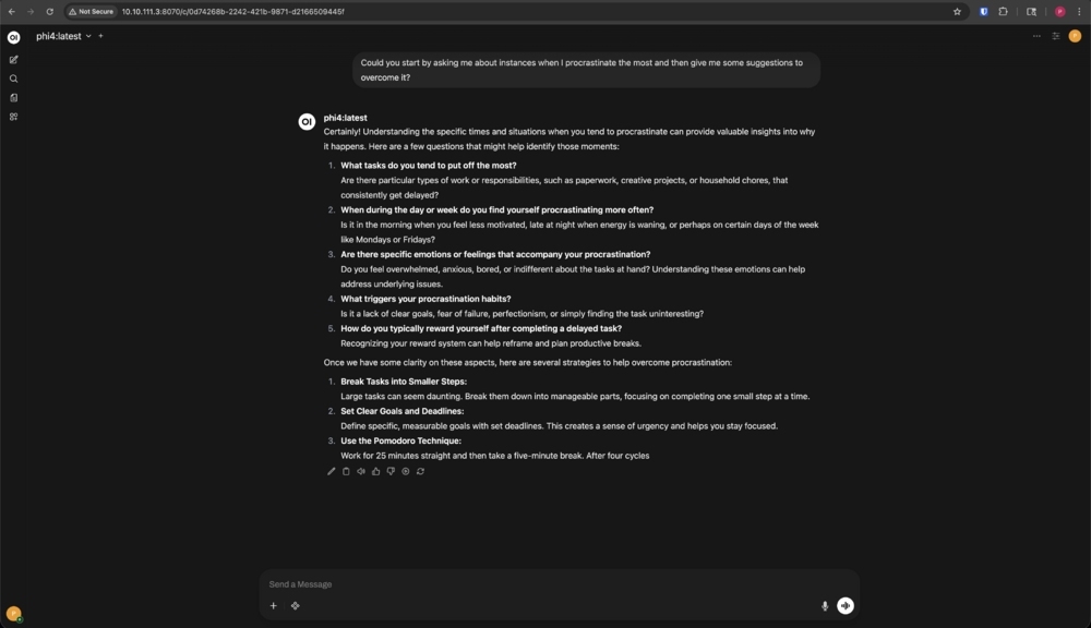

I recently added a NVIDIA GPU to my server with the goal of running local LLM’s. In open webui I added the local connection to my ollama container. If I go to the local address for open webui, I can use the model without issue. Screenshot 2026-02-01 at 11.57.51.png

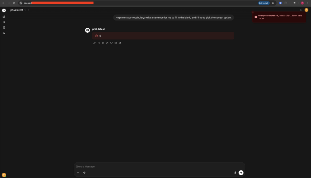

I host this as a service with on a subdomain but when I go to the domain it's hosted at, it doesn't work. I get an error with just brackets.

Ok so for anyone that comes across this thread, I was able to solve this issue by disabling the cache function for this domain inside my traefik config. Once that was disabled, it worked without issue just like I was connected directly to the container.
