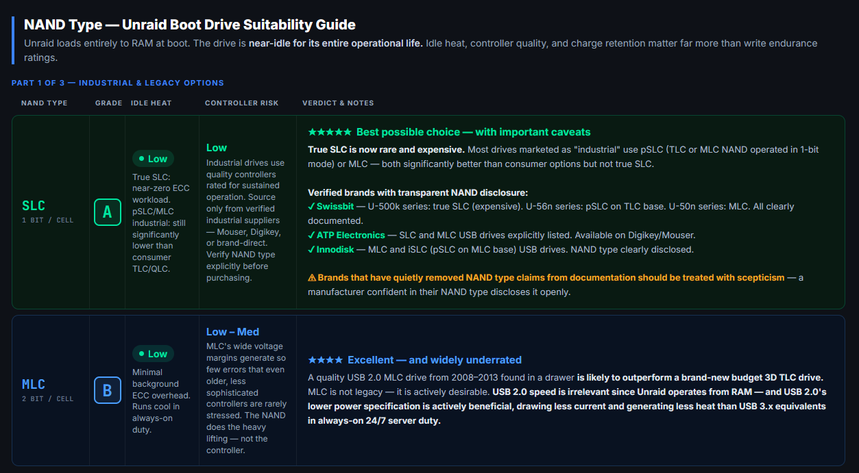

If you are selecting a USB boot drive
Most USB drives implement a hardware read-only protection mode in their controllers -- when the drive detects imminent failure it locks itself read-only rather than allowing further writes that could corrupt existing data.
The result is a drive that can no longer boot the system but preserves the configuration in a fully readable state for immediate recovery.
Insert a replacement drive, copy the config folder, boot.
The failure that felt catastrophic resolves in minutes with zero data loss.
This self-preservation behavior is not as standardized in NVMe drives. When used in combined boot and cache configurations a failing NVMe is less likely to protect the data it shares with the OS partition.

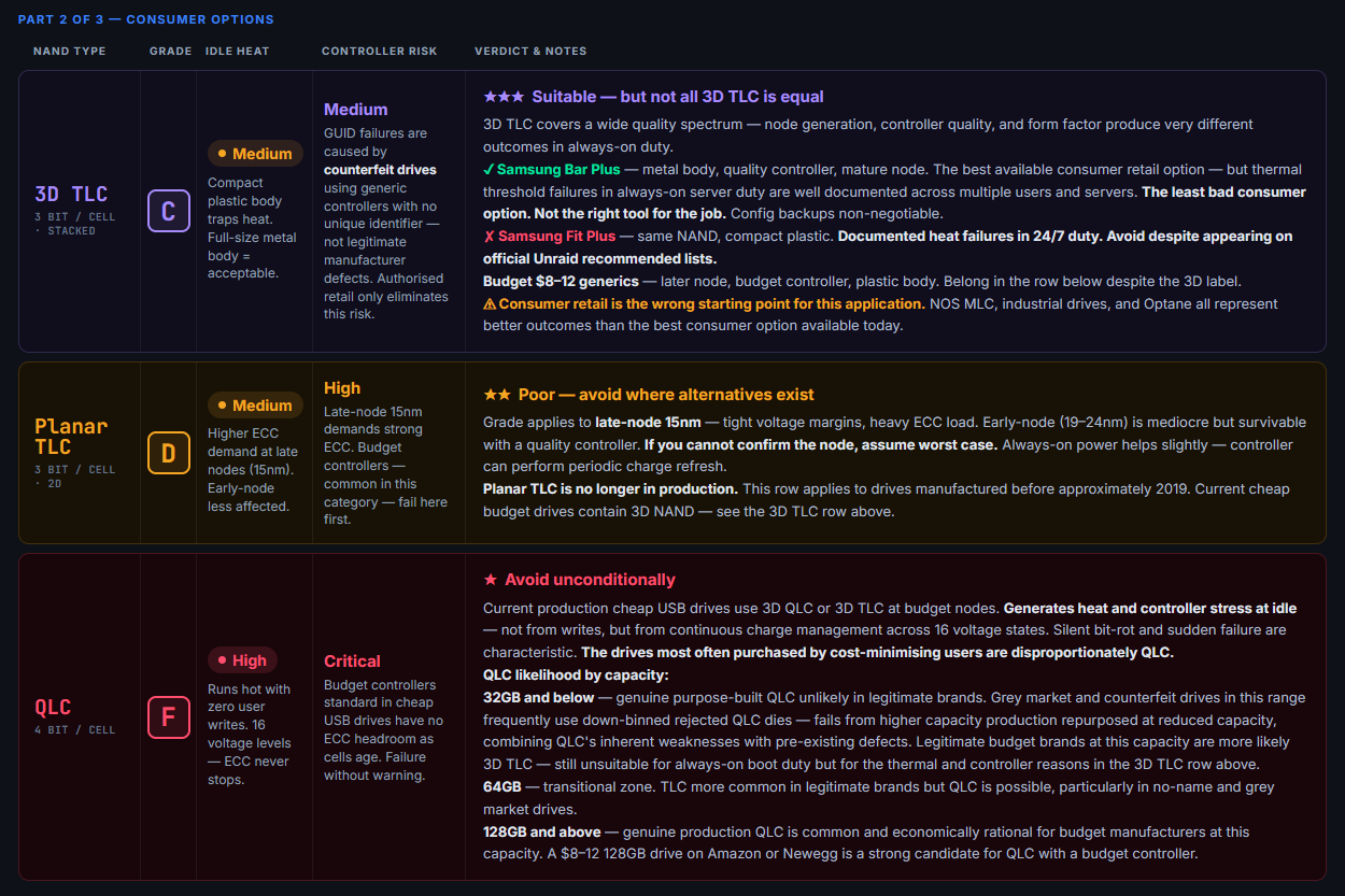

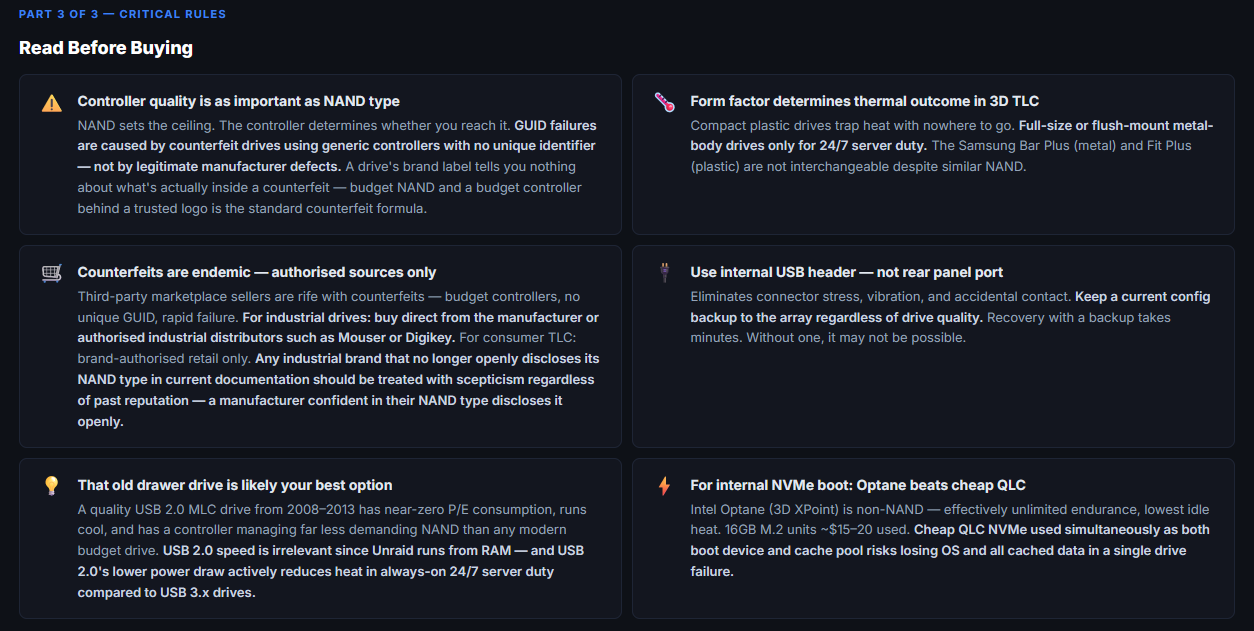

Three rules cover most USB purchase decision situations:
Avoid: Planar TLC, any QLC, USB 3.x drives in USB 3.x ports, unverified budget drives, SanDisk (proprietary controllers).
Target: Planar MLC from 2007-2010 if you can find it.
Verified 3D TLC from Samsung, Kingston, or Transcend if you cannot.
Industrial MLC or SLC if budget allows.
Verify before committing: Use ChipGenius or Flash Drive Information Extractor to confirm NAND type (5 second check)
Do not assume based on brand or purchase date alone.
🚨🚨The single best current purchase available anywhere: 🚨🚨
64GB Innodisk 3ME industrial USB drive -- eBay item 326046070546 -- currently $3.99
P/N: DEUA1-64GI61BW1SC
Industrial MLC, 3,000 P/E cycles, 60-bit ECC, 30μ gold contacts, power-fail firmware, metal housing, S.M.A.R.T. capable*
Confirmed Toshiba MLC NAND via Flash ID decode on purchased units.
This is surplus liquidation stock from a commercial fleet application.
MLC NAND production is being phased out across the industry.
When this listing stock is gone it will not be replaced at the same price.
If you have an unused USB 2.0 drive from a quality brand sitting in a drawer from 2006-2012, verify it with ChipGenius before spending anything. You may already own the right answer.
For the full USB drive selection guide including NAND transition timeline, identification tools, and NOS MLC sourcing, see the post below.

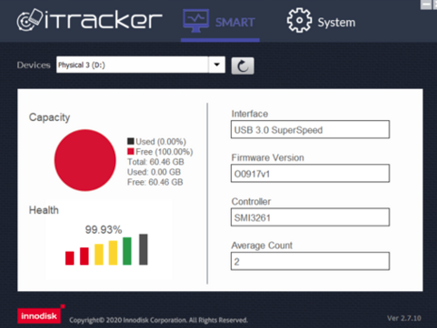

*Innodisk USB Drive 3ME -- iTracker Health Monitoring: Confirmed
The Innodisk 3ME (DEUA1-64GI61BW1SC) drive health monitoring available via Innodisk’s proprietary iTracker utility --
vendor-specific S.M.A.R.T. like metrics such as health percentage and erase count; not standard ATA S.M.A.R.T.
Confirmed attributes surfaced by iTracker on purchased units from the eBay surplus listing:
  • Health percentage -- 99.93% on all tested units confirming factory-new condition
  • Average erase count -- 2 across all units, consistent with production bench testing baseline
  • Firmware version -- O0917v1
  • Controller -- SM3261 confirmed
  • Capacity -- 60.46 GB usable on all 64GB units
Individual anti-static packaging and identical erase counts across the batch confirm these are brand new drives that were never deployed.
iTracker is available directly from Innodisk support on request.
Reference the drive's part number DEUA1-64GI61BW1SC and the SM3261 controller when requesting the utility.

NAND Flash Types: Technical Breakdown and Relevance to Unraid Boot Drives
This section explains the main NAND flash architectures used in USB drives and SSDs, focusing on their cell structure, historical timelines, key characteristics, and why they matter for Unraid's USB boot device.
Unraid loads its OS into RAM and keeps most operations (including standard logging) in memory, resulting in infrequent writes to the USB boot drive -- mainly for config changes, updates, and shutdowns -- making cell interference resistance (to avoid bit-flips/corruption) and low heat signature (to minimize long-term wear in 24/7 operation) key factors for drive longevity and stability.
1. Planar MLC (Multi-Level Cell) – 2 bits per cell (4 voltage levels)
Era: Approximately 2006-2015 in production. Best NOS targets are 2007-2010 -- the window where node sizes remained large enough to deliver maximum reliability while capacity was sufficient for current Unraid installations. No longer in production at consumer scale.
Architecture: Cells laid flat on a silicon wafer at progressively shrinking node sizes. Unlike planar TLC, MLC's two-bit design meant node shrinking was less catastrophic -- wider voltage margins provided meaningful tolerance even as geometries tightened.
Node size timeline (consumer USB drives):
  • 2005–2006...............70 nm – 90 nm
  • 2007.........................51 nm – 56 nm
  • 2008–2009...............34 nm – 43 nm
  • 2010.........................25 nm – 32 nm
  • 2011–2012...............19 nm – 24 nm
  • 2013–2015...............15 nm – 19 nm (final planar generations)
Drives at 34nm and above represent the most reliable consumer MLC generations. Node size shrinks with each year -- earlier is better within the MLC era.
Key characteristics:
  • Interference: Four voltage levels with wide margins between states make bit-flips from neighboring cells rare -- even at smaller nodes. This is the fundamental reliability advantage of MLC over TLC and QLC. The controller managing MLC is handling a significantly less demanding error correction workload than any TLC or QLC equivalent.
  • Heat: Low. Wide voltage margins mean the controller's error correction workload is minimal. Runs cool under sustained use and cooler still in Unraid's near-idle boot application. USB 2.0 power draw compounds this advantage -- MLC's inherent thermal efficiency combined with USB 2.0's lower power envelope makes this the coolest running category available outside of industrial SLC.
  • Endurance: 1,500–5,000 P/E cycles in consumer products. Higher end at 34nm and above -- lower end at 19-25nm late-node variants. In Unraid's near-idle boot application even the lower end of this range represents effectively unlimited operational life. P/E cycle exhaustion is not a realistic failure mode for MLC in this application.
  • Unraid fit: Excellent -- the best consumer option outside of industrial SLC and the most practical recommendation given current market conditions. NOS drives from 2007–2010 with 34–56nm nodes are the primary target. Sealed examples surface on eBay periodically at $10–25 -- verify with ChipGenius on arrival. Check the USB Flash section of this forum for confirmed MLC models with documented component output before purchasing.
2. Planar TLC (Triple-Level Cell) – 3 bits per cell (8 voltage levels)
Era: ~ 2011-2019 in consumer USB drives (declining from 2017 onward as 3D TLC took over)
Architecture: Same flat layout as planar MLC but storing 3 bits per cell, combined with continued aggressive node shrinking to 15nm and below. This compounded both density and reliability problems simultaneously -- more bits per cell demanding tighter voltage margins, at geometries where those margins were already compromised by physical cell size.
  • Interference: Cells shrunk to 15-19nm leave extremely thin barriers between neighbors. Charge leakage between cells -- primarily a quantum tunneling and long-term retention loss phenomenon rather than a thermal effect -- is the dominant data corruption mechanism. This is a passive process that continues regardless of whether the drive is being written to. A drive that reads correctly today may accumulate sufficient charge leakage to fail after months of always-on uptime.
  • Heat: Higher than MLC under equivalent workloads due to more complex controller error management at marginal voltage states. Not as severe as QLC but meaningfully worse than MLC or large-node planar TLC from earlier in the era.
  • Endurance: 300 - 1,000 P/E cycles in practice. Lower end at 15nm and below -- upper end only at early large-node 19nm+ variants. Substantially lower than the MLC range it replaced and the 3D TLC that followed it.
  • Unraid fit: Avoid. Drives from this era are prone to silent, gradual data corruption over months of uptime. A drive that reads correctly today may fail to boot after a year of Unraid use.
3. 3D TLC (Triple-Level Cell) -- 3 bits per cell (8 voltage levels)
Era: Displacing planar TLC in consumer USB drives gradually through 2019–2022. Planar TLC assembled stock remains in retail circulation -- purchase date alone does not confirm 3D TLC. Verify via ChipGenius or buy only from manufacturers that document 3D NAND explicitly.
Architecture: Cells stacked vertically rather than shrunk horizontally -- density achieved by building upward rather than inward. Layer counts started at 24-32 and now exceed 100 in current production. This was the industry's direct response to the reliability ceiling late-node planar TLC had reached.
  • Interference: Vertical stacking puts physical distance between adjacent cell strings, significantly reducing coupling compared to planar designs.
  • Heat: Moderate - USB 2.0, High - USB 3.x The larger 3D die footprint dissipates heat better than late-node planar TLC -- but form factor matters as much as NAND type. A compact plastic USB 3.x drive runs significantly hotter than a full-size metal-bodied drive with identical NAND.
  • Endurance: Overlaps with low-range consumer MLC at the high end but doesn't match large-node MLC at its best. In Unraid's near-idle boot application endurance is largely irrelevant -- idle heat and controller quality are the dominant reliability variables.
  • Unraid fit: Good -- with conditions. The practical choice when NOS MLC or industrial options are unavailable. Use full-size metal body, USB 2.0 port where possible, authorized retail only. The Bar Plus is the ceiling of the consumer 3D TLC category for this application -- and real-world always-on failure reports confirm even that ceiling has documented limitations
4. 3D QLC (Quad-Level Cell) -- 4 bits per cell (16 voltage levels)
Era: Widespread in consumer USB drives from approximately 2020 to present. The dominant NAND type in the cheapest currently available drives.
Architecture: Vertically stacked cells storing 4 bits per cell. Exclusively 3D -- there is no planar QLC. Optimized entirely for density at the expense of every reliability margin.
  • Interference: 16 voltage states packed into a single cell leave microscopic margins between levels. Minor charge coupling from a nearby write can shift a cell by one state, silently corrupting data without triggering an immediate error. Silent bit-rot is a characteristic failure mode rather than an edge case.
  • Heat: Highest of any consumer NAND type. LDPC error correction runs continuously regardless of user I/O -- compensating for QLC's inherently marginal voltage states keeps the controller significantly warmer than MLC or TLC equivalents even at complete idle. This is not activity-dependent heat. It does not stop.
  • Endurance: 100–300 P/E cycles in practice -- the lowest of any consumer NAND type. In a high-write application this matters enormously. In Unraid's near-idle boot application P/E exhaustion is less likely than controller or thermal failure first.
  • Capacity note: QLC dies are not economically produced below 128GB. Any QLC-based drive at 64GB or below is almost certainly a cheap generic, a counterfeit, or built from down-binned rejected NAND from higher capacity production runs -- combining QLC's inherent weaknesses with pre-existing manufacturing defects.
  • Unraid fit: Avoid entirely. The continuous idle heat generation and controller stress make QLC actively unsuitable for always-on boot duty regardless of capacity, brand, or price paid.
Practical Consumer USB drive ranking for Unraid boot use:
  • Best: Planar MLC NOS from 2007-2010 (34-56nm nodes). Large P/E budget (~5,000 cycles), wide voltage margins that minimize controller workload, and no TRIM dependency. Will outlast the server hardware in near-idle boot duty.
  • Acceptable for new purchases: 3D TLC from a reputable manufacturer, full-size metal body, USB 2.0 port. Sufficient P/E budget (1,000-3,000 cycles) and modern controllers with better wear management than their planar-era predecessors. Authorized retail only. Backups non-negotiable.
  • Avoid: Planar TLC (any era) -- thin P/E budget consumed by background controller activity independent of Unraid's writes. Late-node 15nm is particularly poor. Early-node 19-24nm is mediocre but survivable with a quality controller.
  • Avoid: Any QLC.
  • Avoid: Counterfeits and cheap generics regardless of stated NAND type.
  • Avoid: USB 3.x drives in USB 3.x ports -- lower power draw of USB 2.0 operation meaningfully reduces thermal stress in always-on duty.

Industrial USB DOMs at 8GB or above -- from ATP, Innodisk, or Swissbit — are the optimal new-purchase choice for boot pool members where budget allows.
Their MLC or SLC NAND, documented specifications, and internal header mounting make them the most reliable available new-purchase option for this role.
Note that verified 8GB NOS MLC consumer drives from the optimal era deliver superior node geometry to most currently available industrial DOMs at lower cost -- the industrial option's advantage is supply chain confidence and new-from-distributor provenance rather than NAND quality superiority.

    The boot pool's always-on duty makes NAND quality as important here as in any other Unraid boot device role.

A quality MLC USB drive in traditional USB boot configuration already achieves the reliability standard internal boot is designed to reach -- for users running legacy drives that have proven reliable, migration may offer less incremental benefit than the hardware dependency cost warrants.
Internal boot's reliability advantage over USB boot materializes when the NVMe hardware selected is genuinely superior to the USB drive being replaced.

  • Best: Intel Optane M.2 16-32GB with TPM licensing. Optimal technology for always-on near-idle duty, complete USB elimination, effectively unlimited endurance. Available NOS/used at $15-30.
  • Good: 3D TLC NVMe from Samsung, WD, Crucial etc. -- verified manufacturer documentation, backed by latest online reviews confirming 3D TLC. Combined with USB licensing if TPM unavailable, TPM licensing if available.
  • Avoid: Any QLC NVMe regardless of capacity, brand, or price. The continuous idle controller heat, high write amplification and expanded failure scope in combined boot plus cache duty make QLC unsuitable for this role.
  • Avoid: Unverified budget NVMe at any capacity. Apply the same counterfeit and undisclosed NAND type caution that governs USB drive purchasing.
