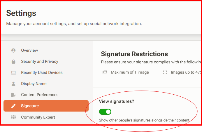

We have all said that at some distant point in the past... 😁 (See my server descriptions below in signature! )
