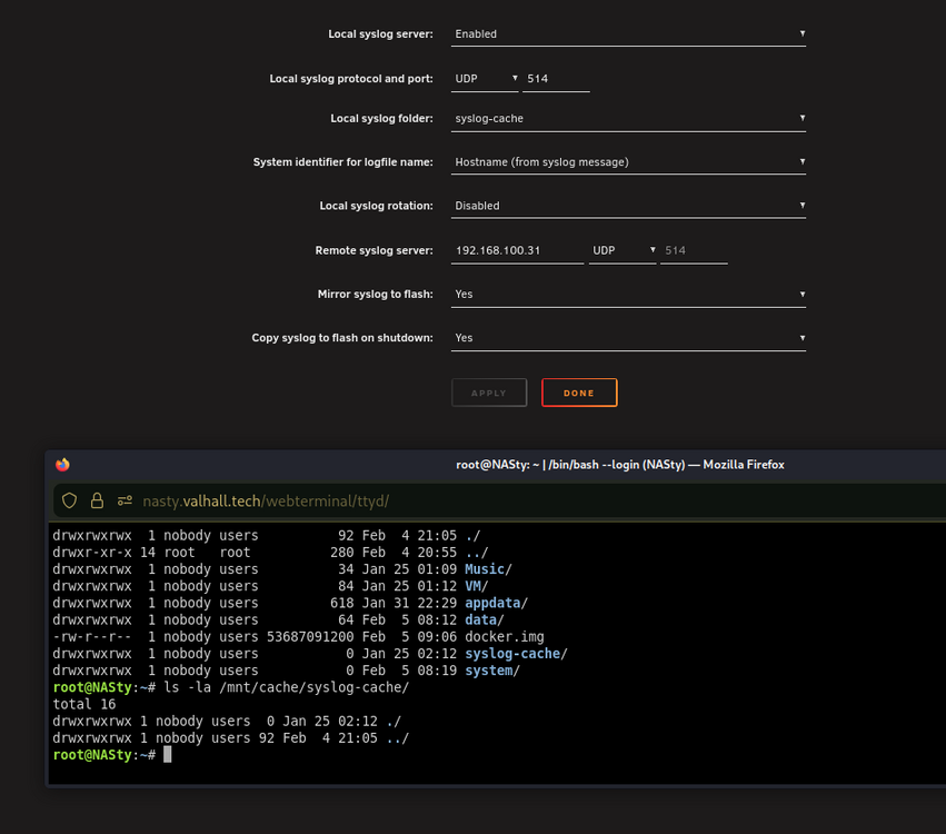

It is and I thought it would have been added to the diagnostics. Where is it usually being stored?
I have also set 'write to flash: true'
To the share where you set it in the options, assuming that part is enabled, that will save a continuous log, unlike the flash drive, which will only have the previous boot.
Hmm... well... seems like something not rly working.
I had to take the syslog server offline a couple of days ago, but that should nethertheless write it locally if enabled, right?
Yes, as long as the server IP is correct.
It is when the “mirror to flash” option is set (which you have done).
I've set remote syslog server to 127.0.0.1... now it created a file. Gonna have to bring back that old server in the near future.

After pressing the power button:
I am currently trying to run the server in safe mode with my containers on but plugins off. One of both might be interfering.
