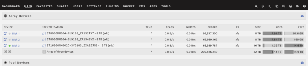

I got a notification (warning) from unraid telling me I had read errors.
I ran a read check (still running), but I see millions of errors, see the screenshot below.
I recently installed the 16To disk.
I recently updated to 7.2.3 (last week), but it ran smoothly until today.
How bad is that ?

Looks like all but disk3 has disconnected, and disk3 also disconnected but reconnected as sde so is now seen as an Unassigned Device.
SMART for sde looks OK and since multiple disks are having problems it probably has nothing to do with the disks themselves.
Looks like you only have motherboard controllers.

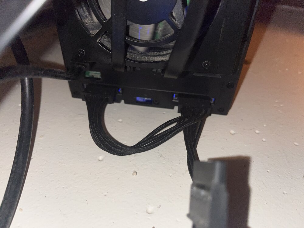

How are these disks powered? Any splitters?

I am not sure of the cable's name but it looks like a splitter.
I have three sata cables coming directly from the motherboard.
And this "single" power cable, coming from the PSU, that powers three drives through two ports on the disk enclosure.
It looks to me like the right hand plug is not seated. (SATA power connectors are notorious for working themselves loose when subject to any force on the connector. It looks to me like you need to 'form' those wires between the two connectors to make sure that it can not occur...)
I have tried to re-plug it properly, it did not seem unplugged, but the server is in a temporary location so it might have been subject to some force as you suggest.

Sorry to not being able to provide more useful information about what fixed (or was) the issue, but it was most likely the badly plugged power cable in the drives enclosure.
