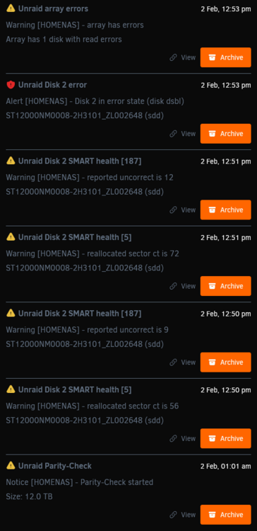

February 10Feb 10 I have a 5x12tb drives + 1 parity. Today I logged into my NAS to find the following alerts/errors. The drive is from 2024 and currently listing 2496 errors. Currently my array shows as "Read-Check 63.5 % • Paused" and I have the option to resumeCan someone please review the diagnostics and let me know how I should proceed? I've not done anything else since seeing the error. The drive is currently disabled and emulated. homenas-diagnostics-20260210-0258.zip
February 10Feb 10 Community Expert No SMART report for disk2. Looks like connection problem. Emulated disk2 is mounted.Check connections and post new diagnostics.

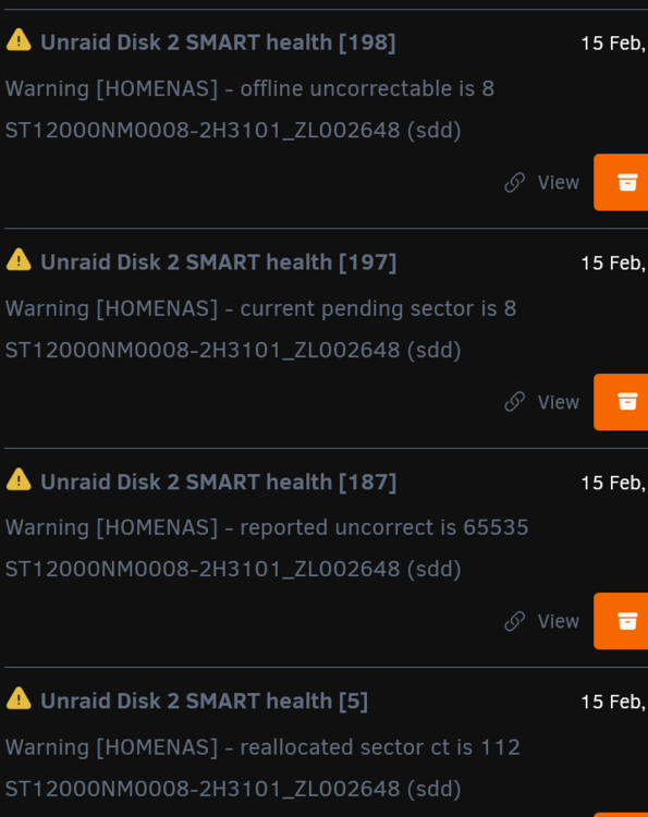

February 15Feb 15 Author Hmm extended test ended out of no where, now I can't start any smart test.Log just says "Read SMART Log Directory failed: scsi error aborted command"Also got the following warnings since boot up. Reallocated is now at 216I'm guessing disc dead, check warranty?
February 15Feb 15 Author 8 minutes ago, trurl said:Post new diagnosticsST12000NM0008-2H3101-20260215-1724.txthomenas-diagnostics-20260215-1735.zip
February 16Feb 16 Community Expert Not getting a SMART report now as noted, but based on those notifications you had you should replace.Emulated disk2 is mounted so should be OK to rebuild to a new 12TB disk.https://docs.unraid.net/unraid-os/using-unraid-to/manage-storage/array/replacing-disks-in-array/#preparing-for-drive-replacement
