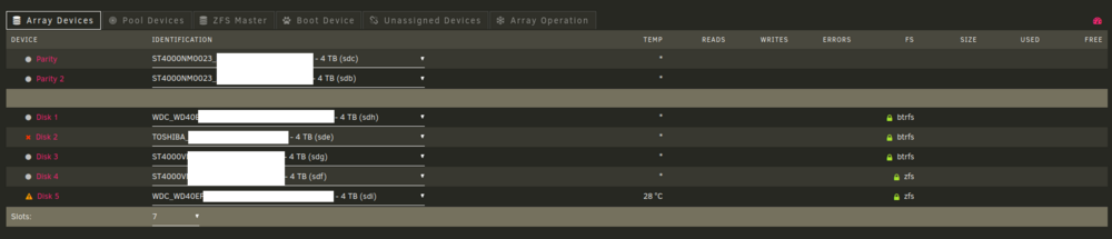

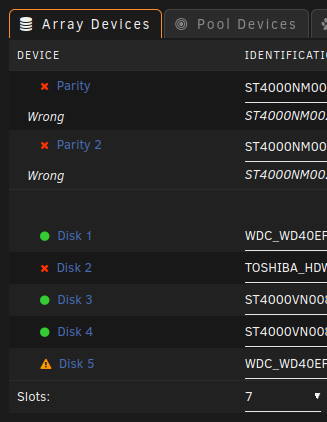

It won't disable more disks than you have parity. The problem seems to be it doesn't recogize either of your parity disks, so you have too many missing disks to start the array.
Post a more complete screenshot of Array Devices.
Thanks, I'll try to restart and take a screenshot again

I really don't know what caused the problem, but after shutting it down for a few days, the 2 parity disks were good, so I swapped the Disk 2 and Disk 5 with 2 spares I had... The parity rebuild went fine (took 8 hours). So far so good. Here's the screenshot you asked, even though it doesn't seem relevant anymore.
