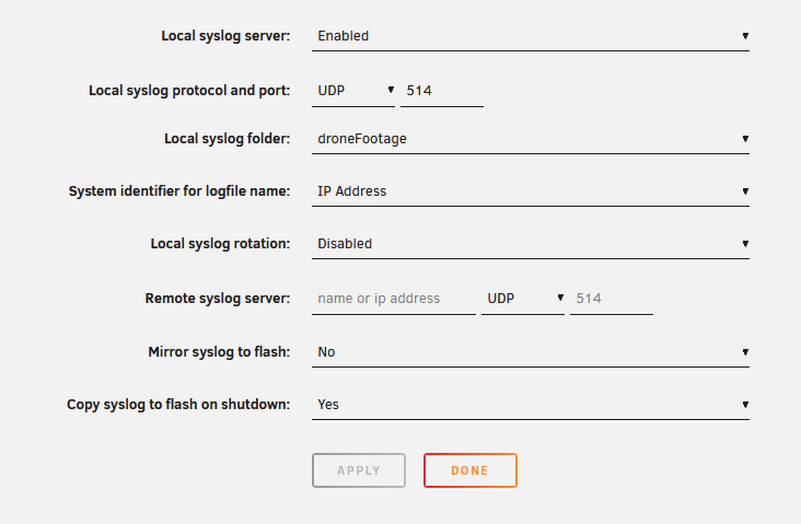

I've also attached a screenshot of what I have setup for the syslog server, however, the logs don't seem to be visible on the selected share. Are these actually present but hidden from the share's directory, or did I make a mistake here?
Additionally I also noticed that when the web GUI ceases to function the server can no longer connect via SSH either, so I'm left connecting to the device physically. Just in case that's relevant to troubleshooting this!

9 hours ago, HomeMediaGuru said:
I am a little bit confused as I don't see any logs saved into the share I selected
See the instructions; you need to set the server IP.
Ah indeed, in one of the detailed lines, mid-sentence, it does mention that. I assumed local syslog wouldn't need it when I first configured it but it's properly setup now.
