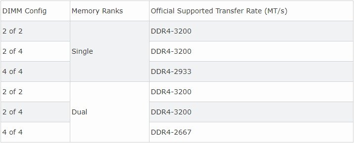

Set your memory speed in BIOS to 3200 (not 3600). The TeamGroup memory is likely Dual Bank, while not called out specifically for Zen3, has always been less stable than Single Bank in earlier Ryzen CPUs.
From Unraid FAQ for Zen3:
