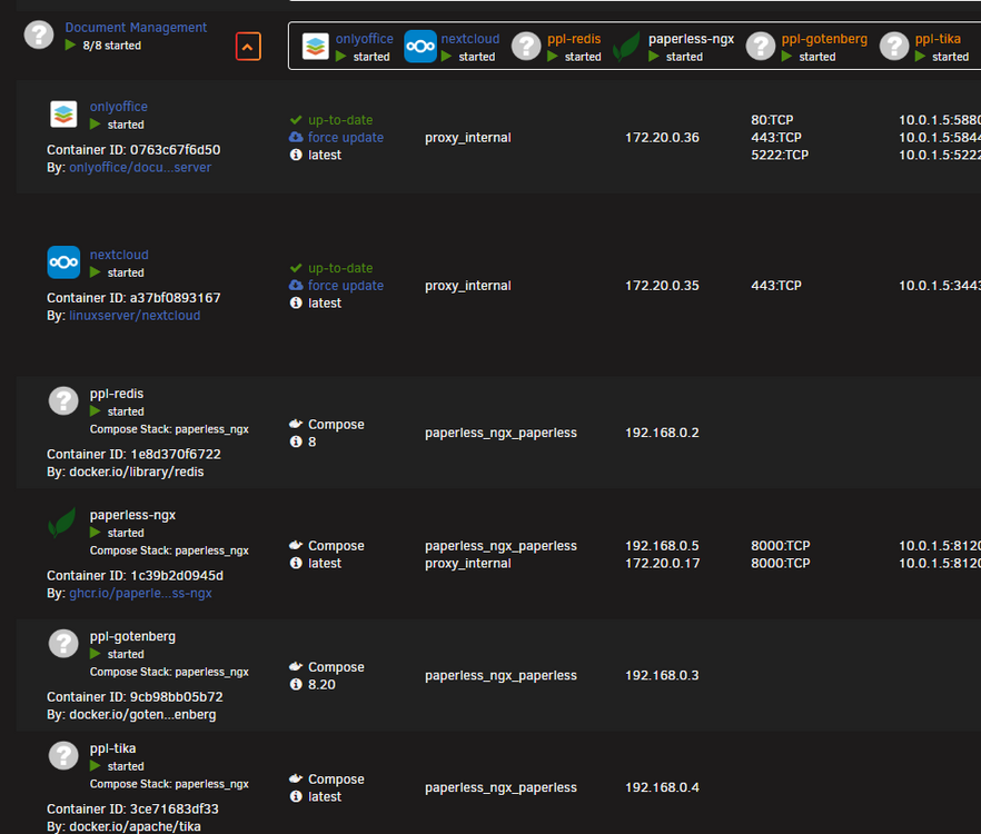

No for compose containers you would usually update them by running "update stack" on the compose manager site. I don't think you can apply an update to compose containers from the normal view. Also in the folded out view it does not show the "apply update" for compose containers - as you see here:
All the paperless containers are compose containers, and for some reason, it is showing updates available for 3 of them, when in reality there are none.
Just looking at the screenshot now, I noticed that the ones that are indicating an update are from dockerhub, whereas paperless-ngx is from ghcr.io. Might have something to do with that....

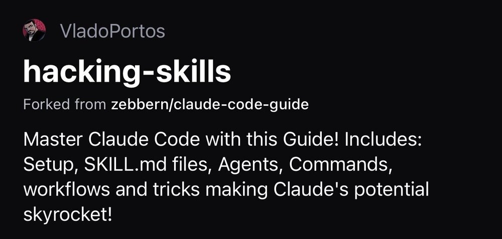

  1. Because VladoPortos, unlike you, has a GitHub account with actual projects he (atleast from looking at it) built and the changes he did to Folder.View2 were to this day 23 commits in a timespan of a few months, compared to your 104 in a few weeks.
    Don't get me wrong. I am not trying to talk down the work you have done so far. As I said initially, it's good that this project is taken care of by someone. It's just that people (me included) could be or are concerned that you don't quite know what you are doing if you just approve claude's work and that this project could be left alone in the foreseeable future and will again need a new dev.
  2. Of course there is a reason I created that PR and don't use that option, because it doesn't make sense. That update column (atleast in my opinion) serves a helpful purpose and especially when having mixed folders (which I do as you can see in my PR) that information text from that column is quite useless. Also, as I wrote in my PR, the fix is not solely for the compose plugin (answering one of your questions later here), but for example also the same problem with "container-managing-containers" like nextcloud-aio.
Also, just to add to my first point as a good example of what could go wrong in an AI written application that the dev doesn't know what he is doing:
https://www.reddit.com/r/selfhosted/s/cYAXggzFoo
I am not saying you should stop, or that something like this could happen (I mean, if you don't add hundreds or thousands of useless features, this can't happen at all), but AI written stuff is still far from perfect (and I know that, having to work with AI is my day to day job...).

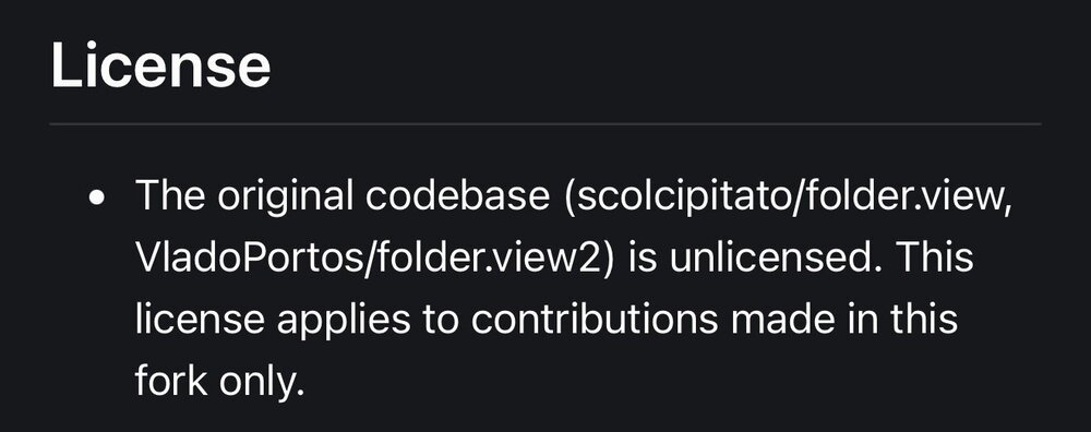

You cannot just add your license to the codebase and call it a day. That license is not legally binding and infact its not even allowed (would count for me aswell as i did the PR) per copyright law. Infact folder.view and folder.view2 are "all rights reserved" projects (wasnt even allowed for VladoPortos to fork it in the first place).
There are only 3 options you have that would make the license hold:
1. You have fully rewritten the code and no original code is left in there, than you can re-license the code
2. You add a notice that only your own code (and contributions) are covered by the MIT license.
3. You ask all original creators and contributors for permission to change the license (so scolcipitato, VladoPortos and all the contributors).
Just wanted to tell you that, as i just saw you added a license. Was in a same situation a while ago and just wanted to share what i know.
48 minutes ago, Joly0 said:
I would also like to add another thing to the input i am giving here:
You claim to have read my repository but somehow you missed this on my readme which makes me less inclined to read all of your posts.
Also Vlados fork was written with AI. I’m not going to keep going on about it because I don’t have an issue with what Vlado did. He also has this repository. Just because someone manually pushes the commit button doesn’t mean they wrote the code. Again, not something I have an issue with, I just have no shame in letting Claude push the commit button after I’ve reviewed the commit.
The main reason why I created my own fork was because there was no one maintaining FolderView2. There hadn’t been a stable release since August and Vlado had been MIA since October and no other user was willing to pickup the plugin.
The fork was intended for my private use but it worked so well and users were still posting issues in the FolderView2 support thread I thought it would be rude not to share it.
If you’re worried in any way and you have the ability and time to maintain this plugin I am more than happy to close this thread and let you fork the plugin. I’ll keep using my version privately.

I did not claim anything, i just noticed, that you added a license, but all good if you have already added a notice. Its not liek i am scanning your repo 24/7.
Also, it appears to me, that you might have misunderstood my initial questions or i might have asked them in a way that you could interpret as rude. Just to clarify, this was not and is not my intention and i am sorry if my questions were not well written and i apologize for it.
I am not against you or the project that you are trying to take over. I am also not against you vibe-coding this project to continue developing it. I just wanted to clarify that maintaining an open-source project is more than just prompting an ai to do stuff and it makes a difference if you know how to code from the beginning and use ai to help you code or if you have zero to low knowledge in any programming language and use ai as your only source of truth. So my initial questions wasnt against you or against vibe-coding in itself, but just wanting to know what experience you have in coding in general and maintaing an open-source project.

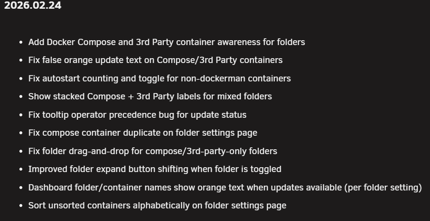

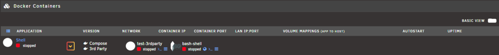

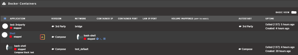

Latest update:
@msalad the alphabetical sorting is in.
@Joly0 and @satchafunkilus I believe I have improved the Compose and 3rd Party awareness. @Joly0 I took a leaf out of your PR and modified it slightly as I didn't like the whole "mixed" thing. The orange update text will nolonger appear for 3rd Party and Compose containers. The useless autostart toggle for 3rd party and compose containers has been removed from the folder line preview line.
Only a compose container = Compose label
Mixed 3rd party and compose = Labeled both
If theres a dockerman container in the folder the Version column goes to default.
Note: You may need to delete your browsing history/cache for some of these changes to appear properly.
Edited by chodeus

Just updated to the latest version. The docker compose changes work nicely, from what I can tell. Thanks a lot for fixing this!
Awesome glad you’re happy! Please let me know if you encounter any bugs I may have missed during testing.

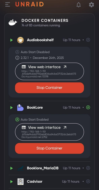

It doesn't appear to be reflecting the autostart state via the Unraid API however.
I have set most of my containers to autostart, but when I use NZB360 and look at my containers, most have 'A' greyed out and say autostart is disabled. Is this something you'd be able to fix without too much effort?
1 hour ago, SakabaRihiro said:
Thanks for this! Held off on 7.2 until I could use FolderView.
Glad to see toggling autostart now actually works consistently, a very nice change!
Glad it’s working for you!
Have you got a screenshot of how the docker page looks in NZB360 so I can understand it? I don’t use it so I need to do some research and see if this is an NZB360 issue or if it’s something I can get to work but it may not be doable.
Fortunately everything else with FolderView3 appears to be working great so I have the time to do some research!
Edit: I assume nzb360 shows autostart correctly without FolderView installed?
Edited by chodeus
Apologies, I was mistaken.
I set some containers to auto-start, then I installed the plugin.
I was using Unraid 7.1.4 with FolderView2, then installed FolderView3 and updated to Unraid 7.2.4, and noticed the inaccuracies in NZB360 with the auto-start labelling (example screenshots attached).
Upon further checking (which I should have done before my previous post), this is the case even without FolderView3 installed, even after toggling auto-start on and off with FolderView3 uninstalled and clearing NZB360 cache.
For the containers that show in NZB360 as autostart being enabled, disabling autostart and refreshing NZB360 results in the container showing as autostart disabled (correctly), but then toggling autostart back on still results in autostart being shown as disabled.
The bug lies with either NZB360 (most likely) or the Unraid API, not with this plugin.
