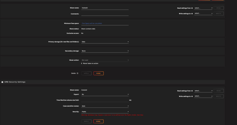

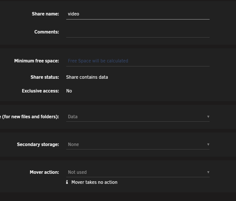

It all seem to work - I only have one, ehm strange thing i cant seem to get.
I have share "Video"
It has the wrong storage linked, it has "Data" should be Data_ex
But i cant edit it at all.
But when i click the icon to the left of the "green" status dot, to go to the share, it goes to the right location on Data_ex.
And from my Emby server its also accesseble no problem. I just cant access from my PC.
I could make a new share, and just move all of the files over, it just seems a bit... excessive to do.
This pic is, is just one of the other share and how it looks
