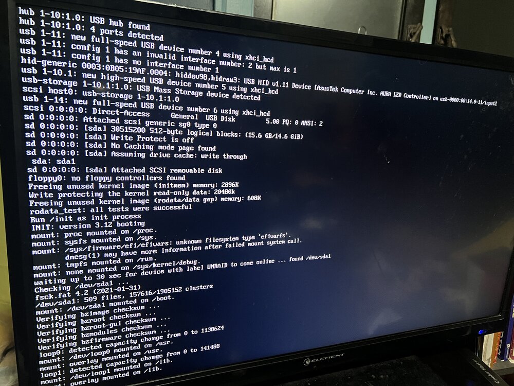

Running Unraid 7.0.0. Been on unraid for a while, but not super tech savvy. Recently my docker containers all stop working and wouldn’t start back up. I shut my server down and it wouldn’t boot back up. Removed my flash drive, put it in my Mac and saw a FSCK0000.REC file. So, I backed up my flash drive, replaced all bz files, and deleted the FSCK0000 file. My server booted up initially, but crashed again. Now when I try to boot up I get a line that says “FAT-fs (sda1) volume was not properly unmounted. File may be corrupted.” It also suggests that I run fsck. I don’t know what fsck is, how to run it, nor could I run it on my server because it won’t even boot in safe mode. If there is anyone that can help me, please explain it like you’re talking to a noob. Pic below, Ty.

I did the fsck check on my Mac. It reported 4263 files and 1,749,755 clusters. I purchased a new flash drive, installed a fresh Unraid 7.0, and copied my config folder from my last drive. Now it’s not giving me the FATfs error, but it’s still not booting and stopping at the same spot. Also tried booting from a different usb port (2.0). (Pic below)

Willl it boot if you don't put your config on it?
Yes, it boots with a clean config folder. Is it possible that I downloaded the wrong version of Unraid? Like I ‘m booting version 7.0, but my config folder is for 6.12 or something else? If that’s the issue is there a way for me to determine what version my configuration is for?

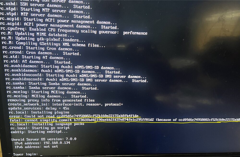

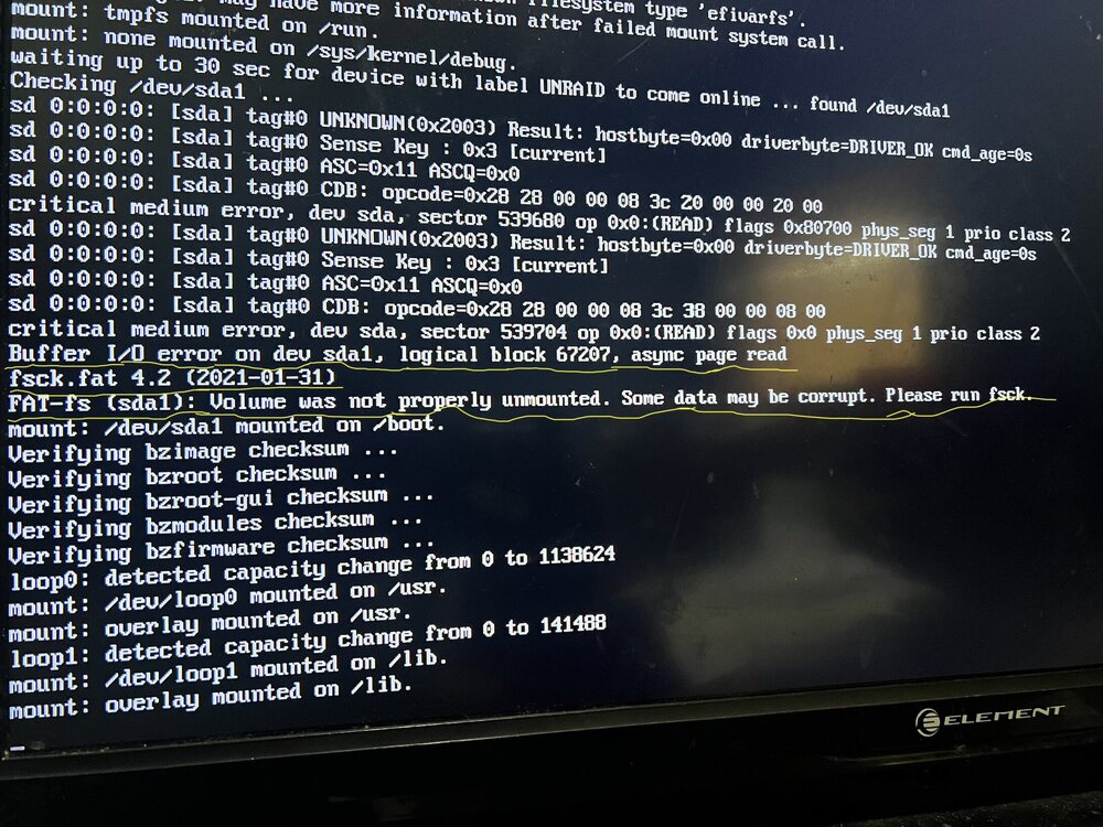

Soooo, I’m still having issues. After getting Unraid to boot I updated my plugins and docker containers while my system did a parity check, which took 2 days. I decided to do some cpu pin isolations to optimize performance. This required me to reboot the system. The tower shutdown, but now I can’t get it back up again. This time the boot seems to complete, but I can’t open the login page on any of my devices. I’m getting the message again that says “volume was not properly unmounted some data may be corrupt.” I’m also getting a new error message (screenshot below) and I have no idea what it means.

Fix this and see if it helps
Feb 22 15:18:09 Tower root: Fix Common Problems: Error: Docker Application Plex-Media-Server has multiple CPUs pinned to isolated CPUs
You should also run memtest since btrfs is detecting data corruption on both pool devices
Fixed the cpu pinning situation, but still having the same issue on initial boot. Grabbed another diagnostic (below), and now I will do a memtest as suggested.
