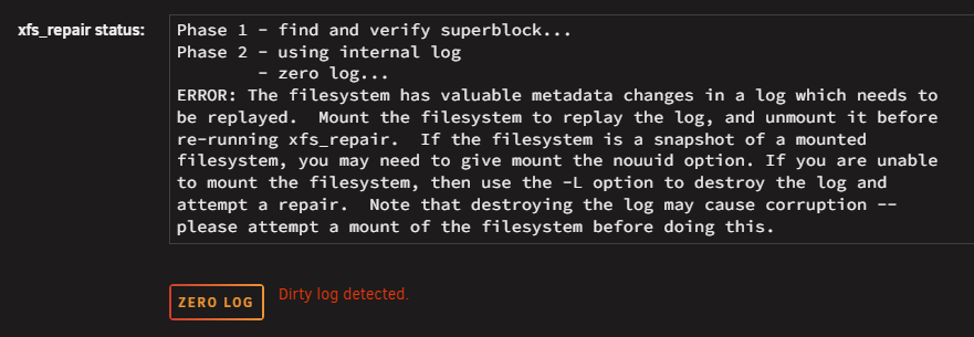

When I try to fix 1NFWTG I get the following back:
ERROR: The filesystem has valuable metadata changes in a log which needs to be replayed. Mount the filesystem to replay the log, and unmount it before re-running xfs_repair. If the filesystem is a snapshot of a mounted filesystem, you may need to give mount the nouuid option. If you are unable to mount the filesystem, then use the -L option to destroy the log and attempt a repair. Note that destroying the log may cause corruption -- please attempt a mount of the filesystem before doing this.
Since I've accidentally mounted and unmounted the disks before I noticed the unmountable disk I assume that nothing might be gained from doing so again but just in case I misunderstand the above message, I'd rather double check before I tell it to zero the log.
How are you doing that? From the webUI? Or from the command line? Several ways to get the command wrong. WebUI will get it right.
From the web UI.
