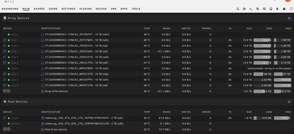

- Disk 6 ST16000NM000J-2TW103_WRS0ZBDN, sde shows as "Unmountable: wrong or no file system"
- Parity is valid with 0 errors
- diskState.6=7 per mdcmd status

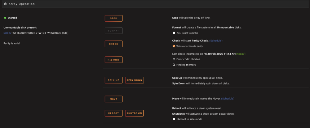

- The Array Operation section only presents a Format option with a warning that Format will discard all data — I have not clicked this
- Reconstruct Write option is not appearing anywhere in the UI

1. What is the correct procedure to trigger a parity-based reconstruction of a ZFS array disk in Unraid 7.2.3 when diskState=7 and Reconstruct Write is not appearing in the UI?
2. Is there a CLI method to force diskState.6 to the rebuild state while the array is stopped?
3. Can the cant_write=1 condition be cleared without formatting?
I have diagnostics zip and screenshots to share if needed. Any help would be greatly appreciated, I want to avoid formatting as parity is valid and the data should be fully recoverable.

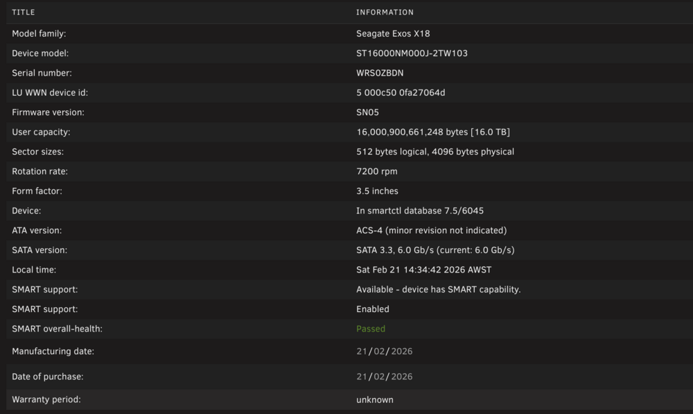

I've replaced the SATA cables indicated for Disk 5,6. I'll attach the latest diagnostics file. No change in the UI regarding the Disk mount issue:
Disk 6
ST16000NM000J-2TW103_WRS0ZBDN - 16 TB (sdc)
38 °C
1.4 MB/s
0.0 B/s
0
zfs
Do you know the correct procedure to trigger a parity-based reconstruction of a ZFS array disk in Unraid 7.2.3?
coruscant-diagnostics-20260221-1433.zip
Edited by x4ngus
Diagnostics attached
